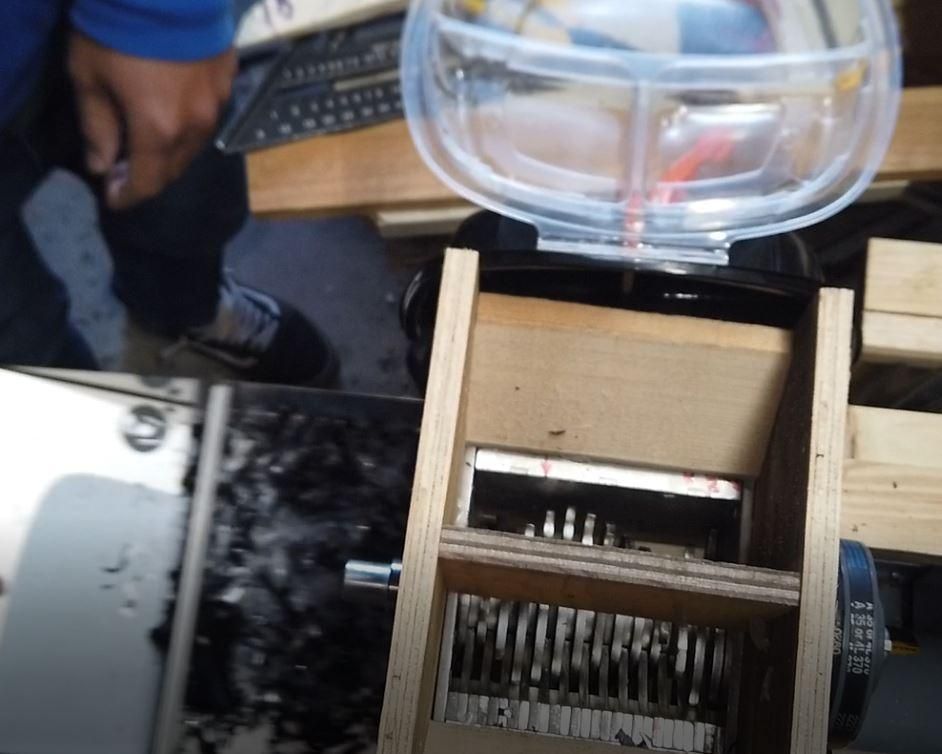

I used recycled Polypropylene Plastic for the stool top because I collected a lot. It's common but tends to be brittle. For a seat top, it's durable enough. You can collect polypropylene:
  • Yogurt container
  • Take-out food containers
  • Kids toy
After cleaning out the food containers, I'll manually shred the plastic. I could also cut with metal shears or power tools, but it's a lot easier to use a shredder or find someone to shred the plastic for you. See below Youtube video of my current process:
https://youtu.be/OVLxsMbxI3E

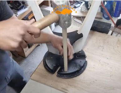

Step 4: ASSEMBLY
  1. I attached the seat tops to the top plate then placed the seat upisde down so the top plate is facing up.
  2. Using a mallet, I set the 3 legs into the middle plate.
  3. Place the top tabs of the legs into the slot of the top plate, and mallet the legs home till tight.
Stools are done!
With a mallet, these tools also come apart easy and can be stored away if not being used.
