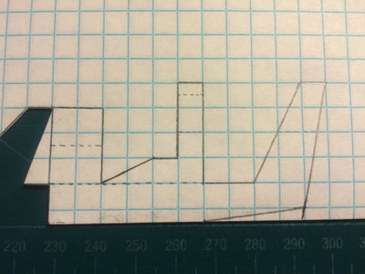

First, begin by folding your your graph paper in half (excluding three boxes on the perforated side). Once the paper has been folded appropriately, make two marks--10 full boxes apart (allow for a further box back behind the airframe). Make the vertical and horizontal stabilizers, spars and counterweight as shown. Follow the photograph markings.

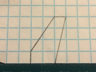

After the fuselage is made, take another sheet of paper that is folded in half along the lines of boxes. Mark out the wing as shown (1 box of constant chord at the root; a leading edge sweep of 2 boxes of chord decaying every 3 boxes outward from the constant chord box; and a trailing edge swept back 1 box for every 4 boxes of wingspan). This will complete the wings.
Solid lines indicate places to cut. Dotted lines indicate fold lines.
Note: 1 box = 0.25 inches

Cut out your fuselage and fold the counterweight into the fuselage. Fold down the horizontal stabilizers, landing gear and spars. Once this is done, unfold down the stabilizers, skids and spars. Then apply tape where designated.

Cut out and unfold your Super StarDragon's wings. Once this is done, align the airframe with the wing and secure the wings to the spars with tape. Cutoff all excess tape and tape the leading edge of the wing to the leading edge root extension at its joint as pictured. Apply one staple in the area of the counterweight folds. This will complete your aircraft.
