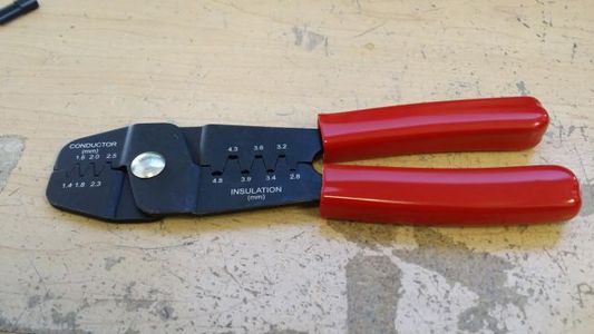

Crimping tools crush the crimp terminals (described above) onto the stripped wire. There are a few different options,we ended up using the WM9999-ND tool, as it was found to be the best of the three choices.
WM9999-ND (Molex part number 0640160038)
  • $46.00
  • Two-step process for crimping insulation and wire.
  • Only does 14-24 gauge wire crimps
This tool is easy to use and intuitive. It makes for a hassle-free, good connection every time.

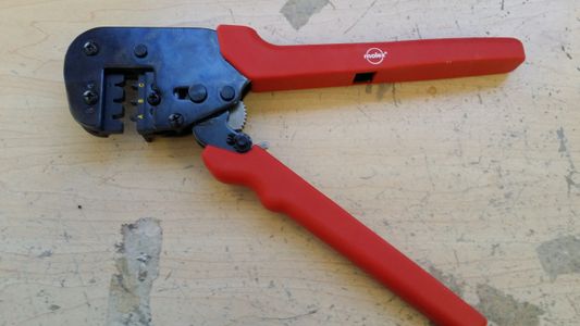

WM17552-ND (Molex part number 0640160201)
  • $130.00
  • Single step
Instructions on how to use this device can be found the Molex website. While this tool is apparently designed to make the process easier, it is exceedingly difficult to position the terminal in the tool using the included magnetic terminal holder. When the terminals were positioned by hand, the device was found to be highly effective at producing a good connection every time.

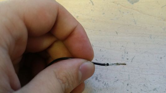

Crimp the forward clasps onto the stripped section of wire.
Step 4:
Then crimp the insulation section.
Step 5:
The final result is a securely connected wire.

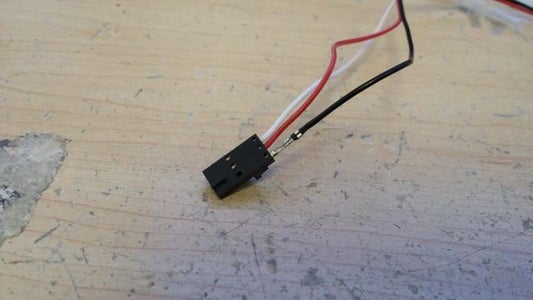

Step 6:
Finally, insert the terminal into the housing, until it clicks into place. Tug on it to ensure it's set.

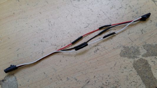

Step 9: Alternative Method: Cable Hacking
As a simpler, if less pretty alternative to all this, you can cut an existing cable somewhere in the middle, remove or splice in additional wire, and solder the ends together to achieve the desired length. When finished, wrap the exposed cable in electrical tape.
