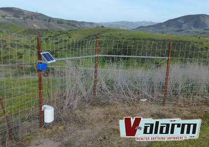

For you to build your own Industrial IoT / remote sensor monitoring units you’ll need things like:
• A sensor hub - GSM sensor hub, WiFi Sensor Hub, or Ethernet Sensor Hub
USB Sensors you would like to use: Meteo (temperature, humidity, barometric pressure), CO2,VOCs (volatile organic compounds), light, 4-20 mA, gases, PM 2.5, any other supported sensors
• Sensor pagoda (build your own)
Solar panels (at least 10 Watts recommended but this varies based on how sunny your location is!)
• Solar charge controller (Adafruit)
• Voltage regulator (if your solar panel voltage is above 6 volts, this is needed to drop your voltage so you don’t fry your battery and electronics)
• Li-Ion 3.7V Battery Pack with PCB (3.7V, 15,600 mAh from Tenergy recommended)
• DC Boost Module / Step-Up Voltage Converter with 5V USB output
• Weather-proof cable glands (PG7)
• Weather-proof 4-conductor cable connector
• Weather-proof DC cable connector
• 2-conductor and 4-conductor cables cut to the length you need for sensor and solar panel placement
Otterbox Dry Box
