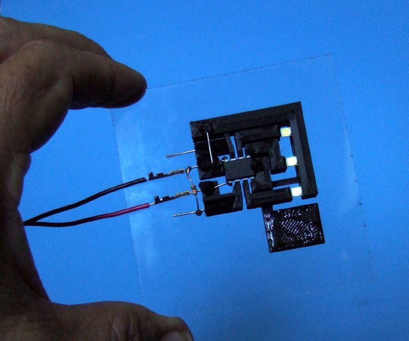

Since I am mainly interested in using Oogoo to embed electronic circuits in flexible forms, this instructable will also show you how to:
1- Make a soft circuit LED pumpkin head robot display that can be embedded on to clothing.
2- Make cleanly etched conductive fabric circuits
3- Make conductive glue using Gorilla glue.
4- Embed circuits in Oogoo or Sugru

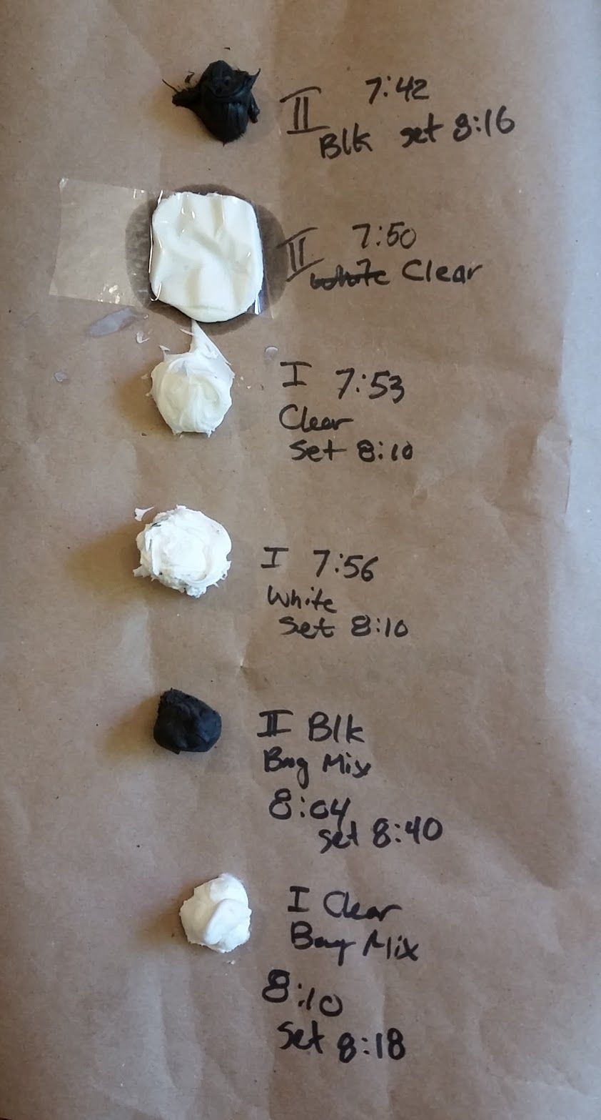

Fast Mix
A mix of 1 corn starch to 1 silicone caulk will be like a putty in 1 to 2 minutes and can then be hand smoothed. In 3 or 4 minutes it will be like clay and can still be molded but is hard to smooth. So, you only have about 5 to ten minutes of working time with this mix.
Slower Mix
A mix of 1 to 3 or 4 will give you up to thirty minutes working time. A 1 to 5 mix can give you an hour or more working time. Depending on how fast it is mixed, the thickness of the structure, the temperature and the humidity, the slower mixes will turn solid and rubbery in from 5 minutes to an hour.

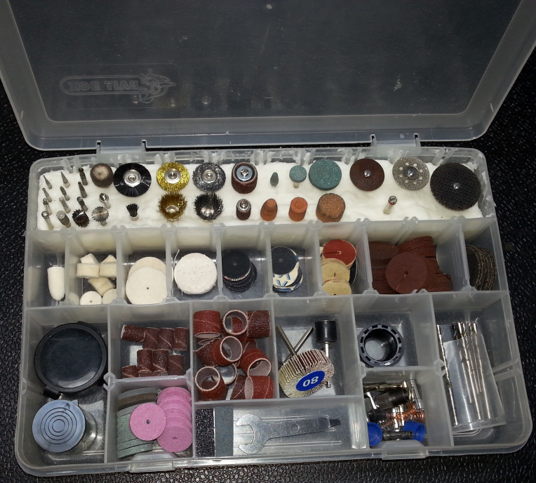

Step 6: Sanding and Carving Oogoo
While you can cut Oogoo with a knife, its rubbery flexibility makes it difficult to get precise cuts. It is more easily carved or sanded with power tools.
I used a stationary disk sander with 150 grit sandpaper to sand smooth the hand formed stopper in pic8. It sands cleanly but It is slow to sand, so before it cures, you should try to hand form the structure as close as possible to the final desired size. I made the mistake of not putting a mold release such as Vaseline on the glass vial and it was very difficult to remove the stopper after it cured.
Oogoo can also be carved with a Dremel tool and a high speed carbide wheel. Wait at least twenty four hours before carving smaller objects and up to several days for thicker ones. Do not carve until the strong smell of acetic acid is mostly gone when you put it up to your nose. Otherwise you will be shooting very small particles containing irritating acid into the air. Not Healthy. Do this outside with a filter mask or with a good vacuum system.

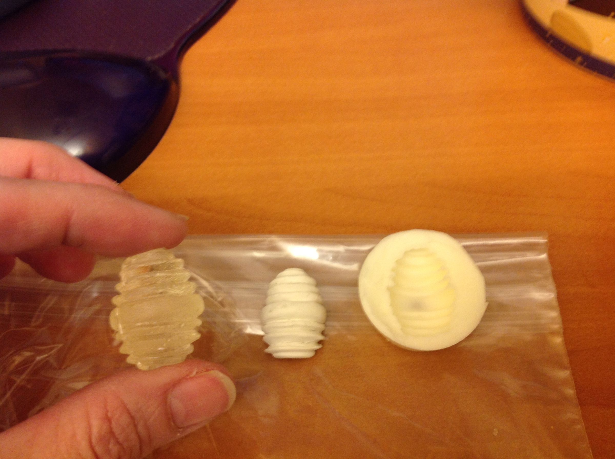

Step 7: Casting Oogoo
Casting In Plastic Containers
Just after mixing, Oogoo is very adhesive and will stick to almost anything. It will not remain stuck to some plastics such as PVC, polyethylene and polycarbonate. So any kind of container made out of these plastics can be used as a form or mold. The blister packs used to package many products contains clean smooth forms that can be used as casting forms. Clear polycarbonate cups and dishes can also be used.

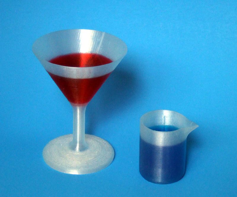

Pic9 shows a funnel shape that was made using the inside of a polycarbonate martini glass. The Oogoo ended up about 3/16" thick and is quite flexible. It could be used as a funnel.
Simply smooth on the mix to fill up the form in layers while working out the bubbles. It does not have to be done in one mix. A fresh mix will stick very well to oogoo that is setting up and also to older Oogoo that has fully cured. So layers can be added at any time.
Casting in Gorilla Tape
Oogoo does not stick to Gorilla Tape so the inside or outside of any container or surface covered with the tape can be used as a form. After it cures the Oogoo will peal easily off.
