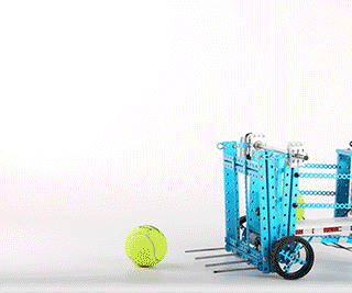

Introduction: How to Make a Ball Launcher
This is a DIY launcher built with Makeblock suits. We used two CNC motors to drive friction wheels, of which the speed can reach 120km/h theoretically. The machine is strong enough because of its metal framework. The maximum no-load speed of the friction wheels could be close to 10000RPM, so that please be careful in your progress of testing.
Glad to tell you that Makeblock is just about to sell this package ! And you don't need pick all the material one by one anymore! http://www.makeblock.cc/friction-wheel-launcher-p...
Step 1: DIY High-Speed Friction Wheels Launcher——Updated Version
We improved our launcher so that it can lauch the ball automaticly now.And the launcher is still improving...We need your support and advice! Most of out components are from Makeblock. And you can choose what you need on: http://www.makeblock.cc/

Step 3: Introduction
Now, I will show you the details of building.
This picture shows all components you need.
Step 4:
1. Build the frame after you prepared all the part.
The picture does not include the necessary nuts and screws.
Step 5:
The main frame is an L-shaped configuration. There is something wrong with the side beams (shown in red arrows), we didn’t notice it until we took the corresponding picture. And it will be fixed later.
Step 6:
Two piece of right-angle connectors are installed on the rear end of the base to fix the hypotenuse of the triangle structure, which is helpful to the rest assembling.
Step 7:
The figure of main frame
Step 8:
Leave the screws of four corners alone when assembling the main flame, for it should be used to set foot pads. All nuts of the frame should be lock nuts, because that this machine has a relatively severe vibration when it works.
Step 9:
Fix the rubber foot pads on four corners of the seat after put on the screw.
Step 10:
The frame finished.
