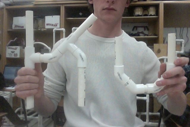

Step 2: Constructing the Braces
1) cut four sections of 16" long PVC
2) cut eight sections of 5 1/2" long PVC
3) cut four sections of 3 1/2" long PVC
4) cut four sections of 1 1/4" long PVC
The two innermost braces are identical along with the two outermost braces, so you will do the same to contrast the identical ones.
For the innermost braces you will need to take one of the 16" sections and put a 45dg elbow on each end, then insert a 5 1/2" piece into each 45dg elbow then put another 45dg elbow on the end of each 5 1/2" section. Then you will insert a 3 1/2" section into each 45dg elbow and then cap both of them with a T-slider outlet. repeat that process so you have 2 identical inner braces.
For the outermost braces you will do much of the same except instead of the 3 1/2" sections there will be a 1 1/4" section between the last 45dg elbow and the t-slider. make two of those then you will have your 4 braces.
