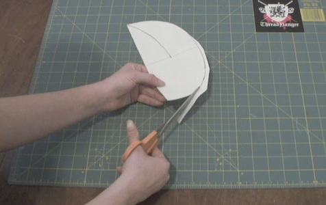

Step 2: Making the Shape

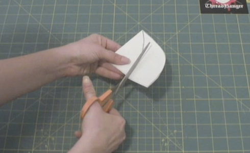

4. Cut along the larger curve to get a half-circle shape.
5. Fold the half-circle in half, along the vertical line, and cut along the second curved line you drew to make sure that both sides are equal. You should end up with a shape that looks kind of like a smile.

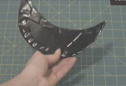

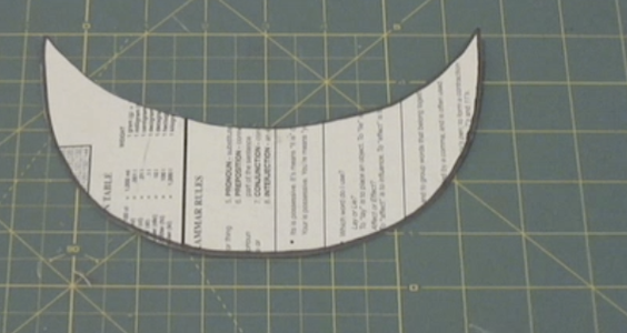

6. Next, trace the shape onto an old composition book cover and cut it out.
7. Cover the shape with duct-tape to make the shape stronger.

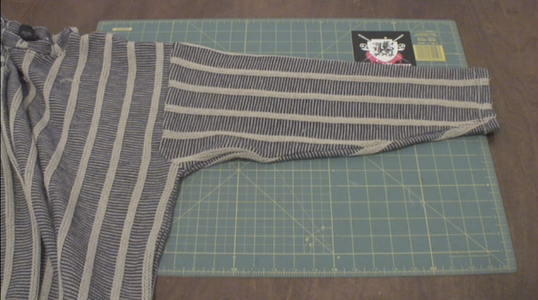

Step 3: The Rim Fabric
8. Take out an old sweater, cut off the arm and cut along the seem for a flat shape.

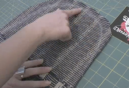

14. Take out the body part of your old sweater, cut along the seems. You only need one half of the body part of your sweater.
15. Fold the fabric in half, along a vertical axis, so that the right-sides are together and pin.
16. Measure and mark 10 inches from the fold. From the middle of your initial measurement, measure 8 inches up.
17. Sketch out a dome shape connecting the 2 end points of your measurement to your 8 inch measurement.
