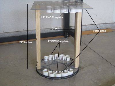

Step 2: Upright and Castle Assembly 2

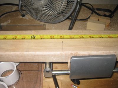

Cut the 2"x4"at 27" inches. Use a miter saw for this as you need a square cut.
Step 3: Upright and Castle Assembly 3

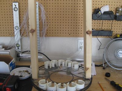

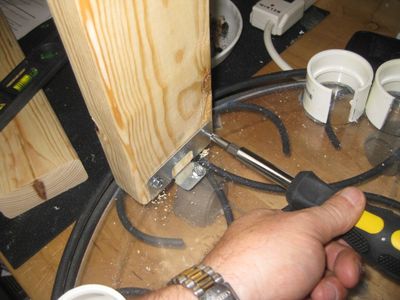

Place the plant caddy on your work bench. Place the cut 2"x4"'s inside the metal connectors and screw together with wood screws.

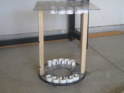

Step 4: Upright and Castle Assembly 4
The unit should now look like this:
Step 5: Upright and Castle Assembly 5

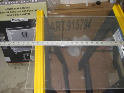

Measure and cut the second piece of plexiglass to 18" inches square. Cut plexiglass along marked edge.
Step 6: Upright and Castle Assembly 6

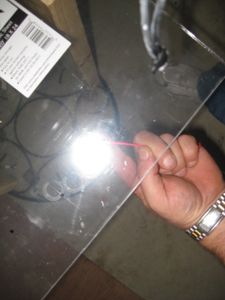

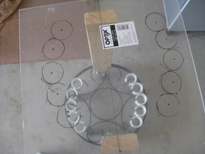

Place the plexiglass on top of 2"x4"s making sure the posts are squarely up and down.
With a plumb bob, find the center of the cell receivers on the caddy below. Place on a dot on the plexiglass for the center of each cell.
Step 7: Upright and Castle Assembly 7

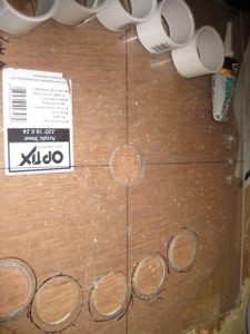

Place the 1.5inch PVC coupler on top of the plexiglass with the dot in the center and outline the outside of each coupler.
Step 8: Upright and Castle Assembly 8

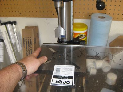

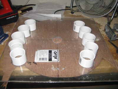

Place the plexiglas on the drill press and CAREFULLY drill out each marked hole with an 1 3/4" inch drill bit.
Step 9: Upright and Castle Assembly 9
Measure 9 from the edge and mark another across the middle. This should give you the exact center. With the 2" inch drill bit, drill a hole in the exact center of the plexiglass.
Clean the burrs off with a rounded file.

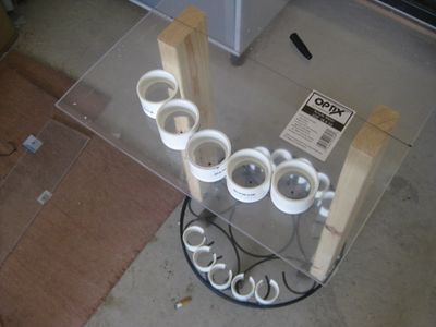

Step 10: Upright and Castle Assembly 10
Turn the plexiglass upside down on the work bench and using the PVC Cement, place a bead of glue around the edge of the 1.5" couplers and mount on the plexiglass.
Repeat for all 10 holes. Allow the Cement to dry for a couple of hours.
Step 11: Upright and Castle Assembly 11
Flip the plexiglass over so that the couplers are facing down. Mark 3 evenly spaced dots on the plexiglass, directly where the 2"x4" is centered. Drill pilot holes in the plexiglass, the secure to the 2"x4"s.
Step 12: Upright and Castle Assembly 12
The completed castle and uprights should look like this:
