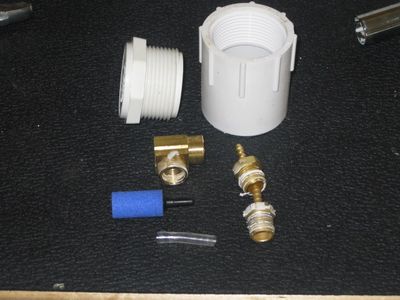

Materials:
(10) 1.25 PVC threaded plugs
(10) Bulk Air stones
(20) 1/8 x � Barb Adapter
(1) Aquarium Silicone air hose
(10) �w Adaptors
(1) Tube 3M 5200 Marine Adhesive
(10) Check Valves
(10) 1.25 PVC Slip and Thread adapters
Tools Needed:
Drill press or power drill.
1/2" drill bit
9/16" deep socket
Socket wrench
Utility knife
3M 5200 Marine adhesive
Assemble all the parts and tools necessary before beginning:

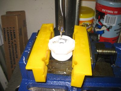

Start by drilling a �e in the center of the PVC end plug.
A drill press works best of this as you can make extremely exact holes.
A regular hand drill will also work. Keep in mind if youre using a hand drill the caps will have a tendency to spin away from the drill. Youll need some sort of clamp or vice to keep the plug and drill bit steady.
Working in plastic and PVC, using a wood drill bit at medium speed and steady pressure seem to work best.

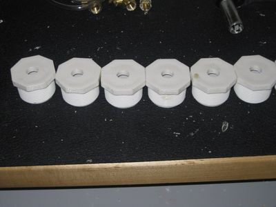

Drill 10 caps.

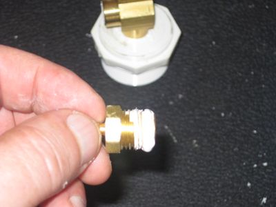

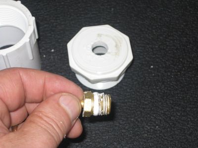

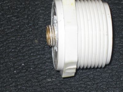

Carefully apply a small bead of the 3M adhesive directly under the barb nut.
Step 5: Cap Assembly...5
From inside the PVC cap, thread the barb into the PVC cap turning the hose barb adapter clock-wise.

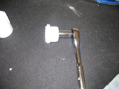

Step 6: Cap Assembly...6

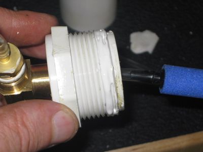

Seat the hose barb firmly into place using a 9/16" deep socket and extender. Carefully tighten, but DO NOT over-tighten.
The hose barb should have approx. 3/8 of an inch extending from the bottom of the PVC cap. Put a small bead of adhesive around the threads.

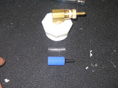

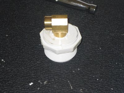

Thread the right angel elbow unto the barb thread. Use your socket and extender to tighten as needed.
Step 8: Cap Assembly...8
Apply a bead of adhesive around the BOTTOM half of the hose adaptor.
Step 9: Cap Assembly...9
Carefully thread the barb onto the right angle. You may need to use a pair of pliers or the socket to seat the hose barb firmly. DO NOT over tighten.
Step 10: Cap Assembly...10

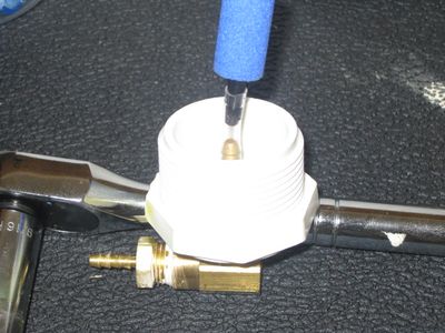

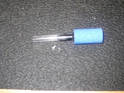

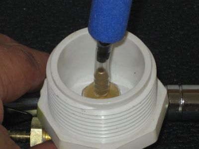

Cut a piece of tubing about 1.25 and connect to the air stone.
Step 11: Cap Assembly...11
Press the air tube with the air stone connected to it over the barb located inside the PVC cap.
NOTE:
If pressing the air tube becomes difficult or kinks, place the end of the air tube into hot water for about a minute. This will soften the air tube and make it more malleable.
NOTE:

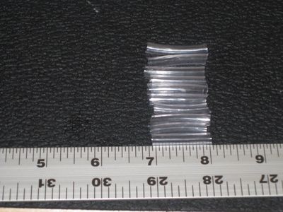

Cut 10- 1 inch pieces of tubing.

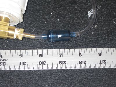

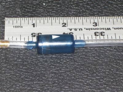

Connect a check valve to the other end of the tubing making sure the arrow points TOWARD from the cap assembly.
Step 18: Cap Assembly...18
Now cut a piece of tubing approx. 4 foot long, and connect the tubing to the other end of the check valve. The completed check valve assembly should look like this, except arrow should point TOWARD cap:
TIP: Try blowing into the tube. You should be able to blow air all the way through. If obstruction, turn check valve around.

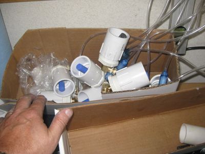

Step 19: Cap Assembly...19
Now complete a check valve assembly for each of the other 9 cap assemblies. Put them all in a box and set them aside for later use.
Your cap assembly and one of the most difficult parts of your PBR construction is now complete.
