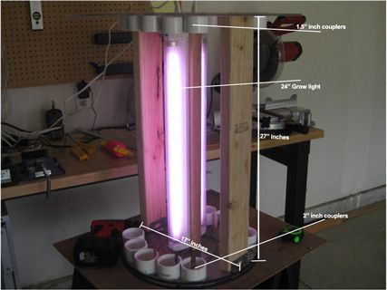

Step 2: Bio Cell Assembly...Part 2
Measure and cut your T-12 tube protectors at 25" inches. Cut all ten.

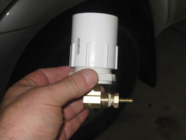

Step 3: Bio Cell Assembly...Part 3
With the 3M Marine adhesive, add a bead of adhesive around the of the cut tube.
Step 4: Bio Cell Assembly...Part 4
Locate the 10 cap assemblies you fabricated earlier. Fit the tube into the cap assembly and push to the bottom snugly.
Step 5: Bio Cell Assembly...Part 5
Fit bio cells into the bottom of the base, by sliding the cell into the top first, then down into the base so that the hose barbs exit through the cuts in the coupler made previously.
Step 6: Bio Cell Assembly...Part 6
Fit bio cells into top castle
Continue until all ten bio cells are in place.
Step 7: Bio Cell Assembly...Part 7
You have completed the bio cell assembly.
