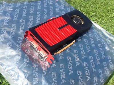

Step 5: Painting Your Heatsink
Get some tape, like duck tape or masking tape. tape off all the vents on your heat sink, you don't want to clog them with paint. You should also tape over the copper plate/pipes that touches your graphics possessor. Also you tape off any parts of the heat sink you want to remain there original color(i taped over the EVGA logo) READ YOU PAINT CAN FOR INSTRUCTIONS ON APPLYING AND DRYING THE PAINT.
Step 6: Re Attaching the Heat Sink.
Remove all you tape, i had a hard time with this in tight spaces, i had to use a number 0 Flathead screwdriver to get the tape of from between the pipes and vents. i also used the screw driver to scrape a few specs of paint of the EVGA logo that got on the sides of the tape.
If you removed you old thermal paste its time to apply your new thermal paste. Now take some good Thermal-paste, I personally use Arctic Silver 5(its like 7$ at radio shack). For the 480 i would use a pea sized ball on the center of the graphics possessor, something smaller like the 650 i would use about half that. you do not need to spread the paste, it will spread out evenly when you screw the heat sink together.

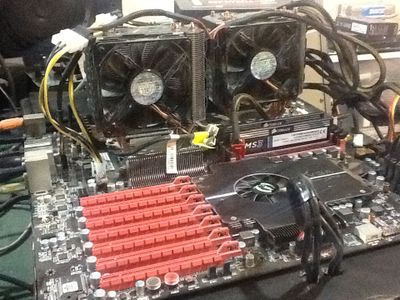

Step 10: Matching Colors
while wating for my 480's fan to dry, i took my CPU heatsinks part and pulled my covers off, i gave my covers 3 coats of paint so my computer is all red and black
