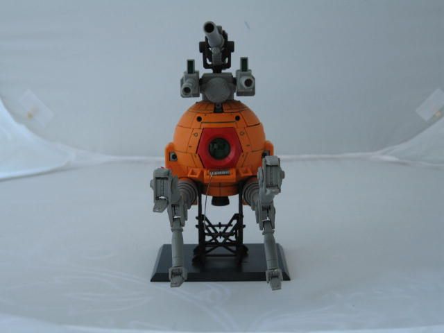

I have been asked to make an ible of how to paint a camoflauge pattern with a rust effect as in my https://www.instructables.com/id/Camoflauge-B-ATM-03-FATTY-GROUND-CUSTOM-airbrushe/... Well, here it is!
