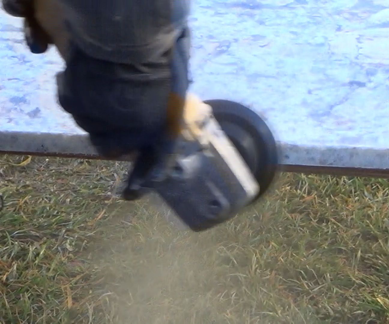

Step 4: Start Polishing With Grit 50
Now, you are start dry polishing of granite. Attach grit 50 dry polishing pad to the Velcro holder and run the grinder at low speed. If you have a variable speed grinder start at speed 2 or 3 that represents rpm less than 1000.
Step 5: Polish From Left to Right
While polishing, move the grinder from left edge of granite to right. Before you finish polishing with grit 50, ensure all saw marks and scratches are almost gone from granite edge. Position the grinder in slight angle and gradually polish the granite edges from one side to another. Be careful at bottom edge to remove objects, do it slowly.
