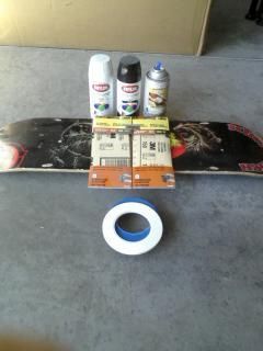

Tools needed:
-Spray Paint
-Spray Primer
-Razor Blades or pen knife
-60 and 150 grit sandpaper (optional)
-Skateboard Deck
-Painters tape
-Pencil for sketching designs

Step 1: Priming the Board
First, you'll need to use your spray primer on the board. If you want it to stick better, use the sandpaper to rough up the old finish on the board. Then just put about 3-4 even coats of spray primer onto the board, and let that dry for a day.
