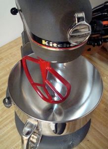

Well if you are anything like me your KitchenAid stand mixer is going strong but the coating on the aluminum paddle and dough hook is long gone. I was tired of getting grey aluminum oxide streaks in my cookies, so I decided to do something about it. I would put a fresh powder coating on them.

Well my timer went off so I grabbed the dough hook/paddle hung them in the paint booth to cool and packed the gloves away. Once they had cooled down and I was still thoroughly baffled by what the heck the guy was cutting out of the steel on the water cutter. I packed up my dough hook/paddle in my bag and headed home to install them. I think they turned out great and after seeing some of the awesome colors you could choose this could be a great way to personalize your KitchenAid. I think the red looks great with my gun metal mixer which is now truly one of a kind.
