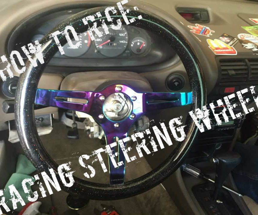

Want to see that bitchin' steering wheel installed? Head over to my page and take a looksie. Will be wrote up 8/12
