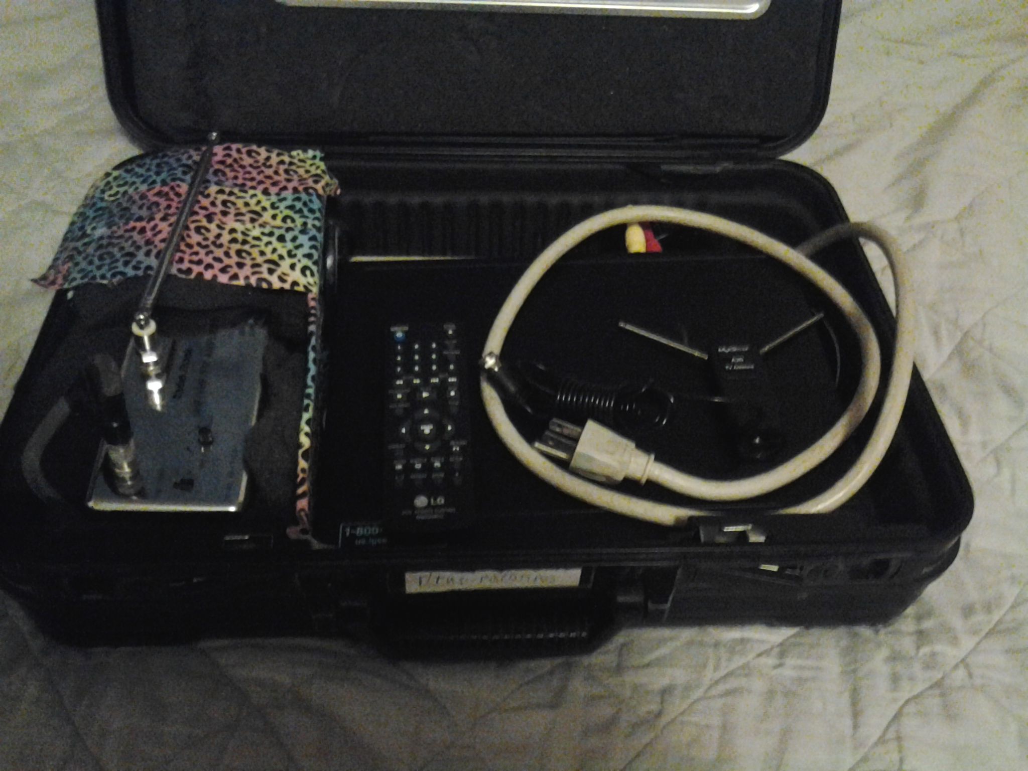

Yay Tv Station is cool. i make the "lego TV" Station use pico macon, video sender
