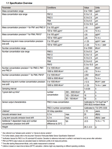

Step 1: What Is the SENSIRION
The SENSIRION SPS30 is a Air quality sensor that uses Laser Scattering to detect particulate,
This works as shown in the attached diagram,
  1. Blower Fan pulls in ambient air
  2. Air flows through a laser diode channel
  3. Partials in the air cause the laser light to scatter & hit the light sensor
  4. The non-scattered laser light gets absorbed into a special surface which avoid any additional scattering
  5. Air is exhausted out of the unit.
An MCU processes the data measured by the light sensor to determine the size of the particles.

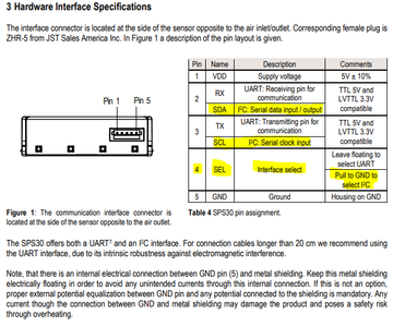

Step 2: How to Wire Up
The SPS30 module can be connected in either UART or I2C communication mode.
These modes can be selected using the SEL pin, SEL > GND = I2C while SEL > Floating (Not connected) = UART
For this demonstration I will be using the sensor in I2C mode,
The pin connections will be
SPS30 | Arduino
GND > GND
SEL > GND (Selects I2C Mode)
SCL > A5
SDA > A4
VDD > 5V

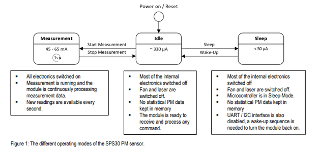

Power Consumption
This module as you might expect can draw a lot of power as it has a laser diode and a fan inside of it, that means that while it is running with everything active it is drawing around 5mA @ 5V meaning in this state the module is drawing 25mW. While this is quite low for a device with supply power this could be problematic for a low power battery application.
Luckily Sensirion have considered this already and published a report on how to optimse for this here.
The big take away from this is to only enable the fan for short pulses as that is the main power draw, we can do this with the Arduino library with the following commands,
  • sps30_start_measurement(); This will enable the fan, we should call this before measuring and give the sensor a few seconds before beginning a measurement
  • sps30_stop_measurement(); This command stops the fan, bringing the current draw down to <1mA once the measurement is done run this before going into "Sleep" mode.
