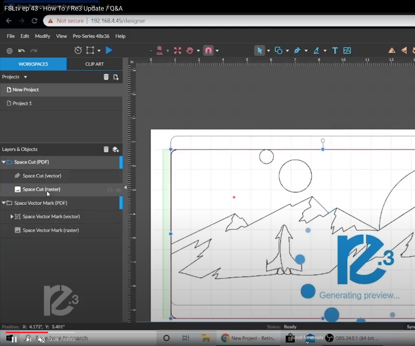

- Starting on the PS48, we're going to begin by cutting out our shapes from the wood.
- We have our setting at Speed: 30 Power: 100 Current: 100
