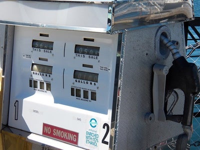

Step 1: Fill Her Up
A good place to start is to fill up your boat’s fuel tank to maximum capacity in order prevent condensation accumulating in your fuel tank, which can result in dreaded diesel bug contamination. Due to the fact that diesel is an organic fuel it offers microscopic fungi an ideal opportunity to breed and grow.
Diesel bug usually originates from air or moisture inside the tank, and once inside the tank, the bacteria can lay dormant for an extended period of time. Once this bacteria comes into contact with even the smallest droplet of water, they will begin to rapidly reproduce inside the tank.
Once the contaminated fuel enters the fuel system, it can be extremely difficult to eradicate, and needless to say, expensive. An affected vessel will experience accelerated corrosion and will require immediate attention.

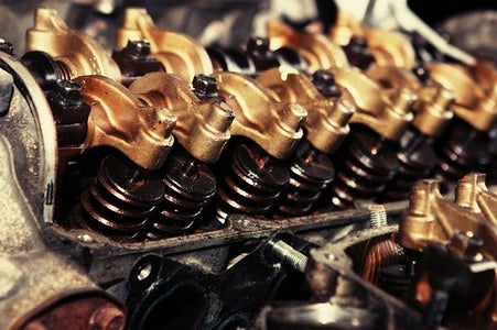

Step 5: Change Your Oil & Oil Filter
Changing the oil filter on your boat can more often than not prove to be incredibly messy and will certainly require a good collection of rags to clean up any spillages. In addition to this you will also need a good quality filter wrench that will not damage your filter. Carbon and other combustible products tend to build up and restrict the flow of oil to the engine. Therefore, it is important to change it at least once a year.
One tip that I would recommend is to use a plastic bag and wrap it around the filter to catch the oil and filter. I would also suggest using a barrier cream to protect your hands as old engine oil is composed of a vast amount of carbon and can be very difficult to clean.
It is also a good idea to change your engine oil as well. This is a simple process and ensures that no corrosive acids are present in the engine over winter.
