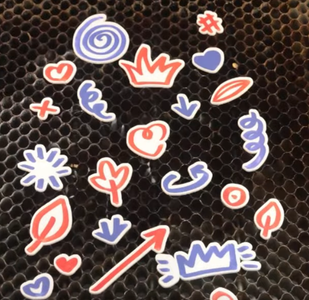

Step 1: Draw and Place Your Acrylic for Laser Cutting
Choose a piece of acrylic and draw on it with permanent markers as you go. We recommend using white acrylic for a strong contrast that will highlight your creation! Then put the drawn acrylic board on laser honeycomb bed.

Step 6: Assemble the Hand-Drawn Acrylic Patch
Once the acrylic laser cutting is complete, it’s time to remove the parts. Then use hot-melt glue to affix them onto the surface of canvas bags or accessories!
glue hand drawn acrylic patch
