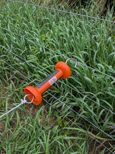

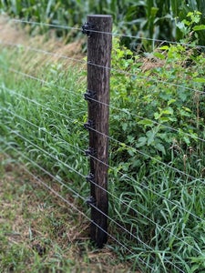

Permanent Perimeter Fence
We use an 8 wire high-tensile electric fence that does a great job keeping livestock in and predators out.

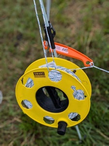

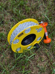

Temporary Fence line
Poly-wire works great when made into spools with extension cord reels!

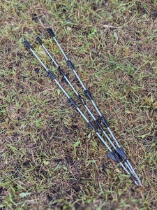

Temporary Fence Posts
We use fiberglass step-in posts.

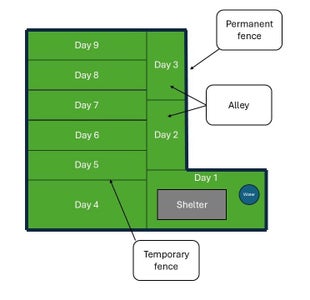

When planning the paddock layout, the goal is for the livestock to always have access to water and shade, while not over-trampling the pasture which can stunt the growth of the grass.
As seen in the diagram above, we build an alley across the pasture, then section it off into smaller paddocks that open into the alley.
The alley is for reducing foot traffic across the majority of the pasture and enables us to close off each smaller paddock once the livestock finish grazing.
Figuring out what size paddocks to make depends on how many head of livestock you have and the quality of forage available.

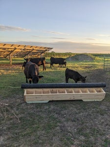

Because cows don't get all the nutrients they need from the pasture, supplementing their diet with minerals is essential.
Pictured above is our free choice mineral feeder that we built. The idea is that the livestock will choose what minerals they need to supplement their pasture-based diet, as well as return nutrients back into the soil through their manure.
