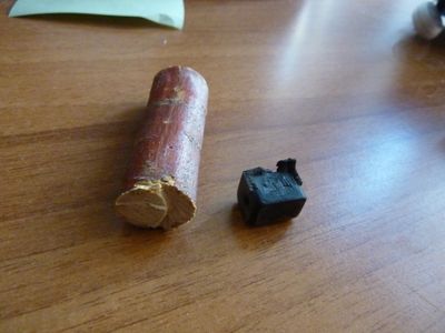

Step 1: Find and Cut the Wooden Stick
Find a piece of wooden stick thicker than the base of the plastic lever. Cut it on the appropriate length with your hacksaw.

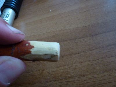

Step 3: Whittling
Using a good knife, curve out enough material from the stick so it has same the shape with the base of the plastic lever.

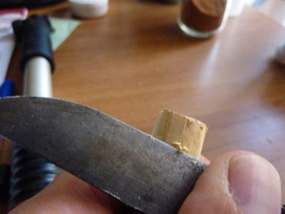

Step 4: Whittling 2
Using your whittling skills again, make a nice handle out of the end of the wooden stick. Its pretty easy.

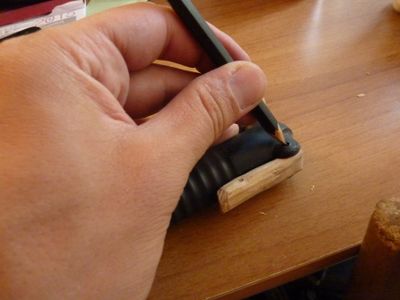

Step 5: Mark the Hole
Then put it no its place on the pump and test to see if it fits. If it
does mark with a pencil where the metal rod will go through.

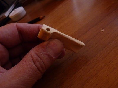

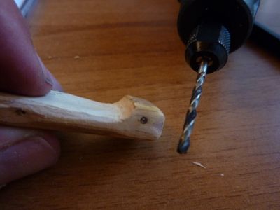

Step 6: Open the Hole.
Use your dremel to open a hole for the metal rod. It should look like the original handle. You can use sandpaper to refine it.

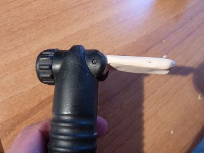

Step 7: It's Almost Ready
It should look similar to this:

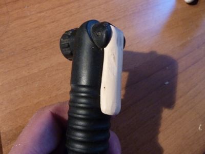

Step 8: Ready!
That’s it, test it to see if you have trouble lock/unlock it. You can
easily fix problem like this by removing some material. You can see how mine looks!
