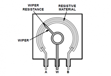

Step 2: What Its Made of and How It Works
If you look at the picture- I wish I had seen this earlier- you can see that the first and third pins are joined by a resistive material, and the middle pin is connected to a wiper, which can slide around, changing the amount of resistance the middle pin and the outer pins.
Note that as you turn the wiper, resistance between one of the outer pins and the middle pin decreases, while the resistance between the middle pin and the other outer pin increases. That is why if you wire either of the outer pins and the middle pin, you will have a variable resistor.
Also you can switch the outer pins and, as a result, the direction of rotation will be flipped. For example, if you had to rotate right for a certain outcome, after reversing the pins, you would have to rotate left to get the same outcome.

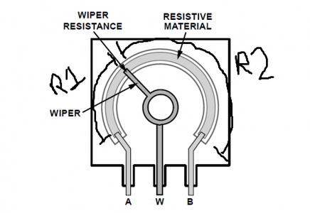

Wait a second, if the middle wiper is connected the one of the arduino's voltmeter probes, then it is basically in the middle of two resistors in series (the resistive materials on either side of the wiper. It'll make more sense if you look at my drawing over the diagram of the potentiometer. So as you turn the knob, one resistor gets bigger, and the other gets smaller, and voila, the arduino gets a varying input.
