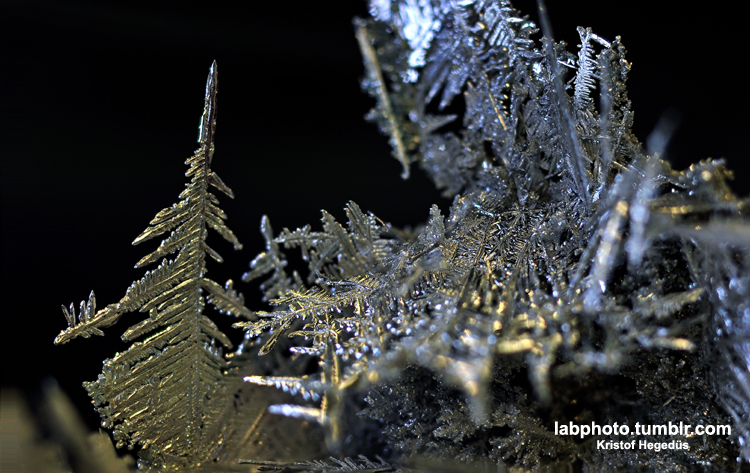

In this case I had made a photo from a crystalline solid at the bottom of a breaker at the lab where I work. The was also no light for an optimal photo, so I had to use this little trick to make this photo:

My 4 pic looked like this:
