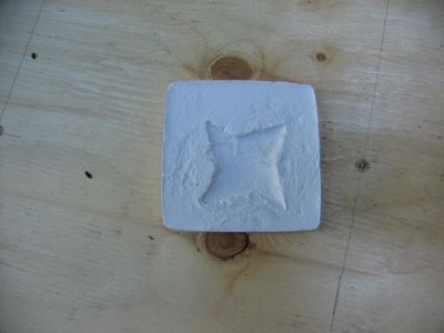

Open the canister of acetone and pour some acetone into the glass container. You don't need much, 1 centimeter should be enough for a little batch of plastic. If theres not enough you can always add some more later.
Step 3: Melt the Styrofoam
Then wait one to five minutes for some of the acetone to evaporate. Wait one minute if you want it to mold the plastic and five if you want to shape it. The more you let the acetone evaporate the more solid it will be. You might even want to mold it while its still "liquid".
Here's a video that demonstrates the melting process.
Step 4: Other Usefull Info
If you do not use the plastic immediately cover the container in which you put the plastic.
If your plastic becomes to hard to work with dip it in some acetone to make it soft again.
The plastic fully cures in about 12 hours.
