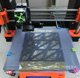

Step 3: Laying Down the Mesh
During the print process, integrating the mesh is a critical step since the mesh connects all of your panels together. When your printer reaches the pause point, follow these steps to lay down the mesh correctly.
Instructions
  1. Pause the Print:
  2. When the printer pauses as programmed in your G-code, make sure that you have enough clearance between the printhead and the print. This is automatically done with a Prusa, but your printer may require you to lift the Z-height if you haven't added that G-code during the slicing.
  3. Prepare the Mesh:
  4. Cut a piece of mesh slightly larger than your print bed. This allows for secure attachment without stretching the material.
  5. Lay the Mesh on the Bed:
  6. Place the mesh over the print bed, ensuring it fully covers the printed areas.
  7. Start by securing one corner with a binder clip.
  8. Move to the opposite corner, pulling the mesh flat but not stretching it.
  9. Repeat for the remaining corners, eliminating any ridges or kinks in the fabric. Use additional binder clips as needed to hold the mesh securely.
  10. Double-Check the Mesh Placement:
  11. Inspect the mesh to ensure it lies flat and does not overlap or fold.
  12. Make sure it aligns with the areas where the hinges will be integrated.
  13. Resume Printing:
  14. Continue the print process and carefully monitor as the filament begins to print over the mesh.
  15. Watch for:
  16. Proper adhesion of the filament to both the mesh and the underlying printed plastic.
  17. Burrs or ridges in the print that could catch the printhead.
Tips for Success:
  1. Avoid Stretching the Mesh: Stretching can cause uneven binding and affect hinge functionality.
  2. Use Extra Clips: If the mesh moves during printing, secure it with additional clips.
  3. Binder Clip Placement: Make sure that the clips won't hit parts of the printer when the printer starts backup!
  4. Monitor the Print: Keep an eye out for any issues that might arise, such as the printhead catching on the mesh or improper adhesion.

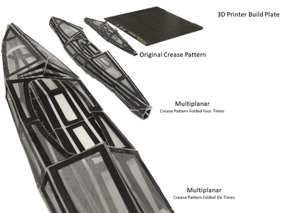

Step 5: Repeat Steps As Needed for Your Design
Depending on your design’s complexity, you may need to repeat the process of laying down mesh (Step 7) and Kapton tape (Step 8) multiple times. For the Kresling pattern, this involves two layers of mesh and one layer of Kapton tape.

With some models, this can get quite complex. For the Kayak, we've included a list of steps to help you.

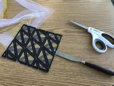

  3. Be gentle, as sudden movements might damage the mesh.
  4. Detach the Print from the Bed:
  5. If needed, use a scraper or spatula to carefully lift the edges of the print.
  6. Work slowly around the edges to avoid applying too much force.
Tips for Success:
  1. Use the Right Tools: A flexible spatula or scraper is ideal for gently lifting prints.
  2. Avoid Force: Excessive pulling or prying can warp the print or damage the mesh.

  1. Trim the Excess Mesh:
  2. Using sharp scissors or a craft knife, carefully cut away any excess mesh around the edges of your print.
  3. Be cautious not to cut into the embedded mesh or the printed parts.
  4. Inspect the Kapton Tape:
  5. Identify where the Kapton tape is adhered to the inside of the print. One side may be tougher to remove due to the adhesive.
  6. Removing the tape from tight corners will be challenging!
  7. Remove the Kapton Tape:
  8. Use a small, pointed tool (like tweezers or a dental pick) to carefully lift an edge of the tape.
  9. Slowly and steadily peel the tape away from the print.
  10. This is very challenging with the kayak due to the small enclosed space! Once you've lifted up part of the Kapton, try using a pencil or another small tool to help you lift the rest of it up and push it out through the end of the kayak!
  11. Clean the Print:
  12. Inspect the print for any leftover tape adhesive or stray mesh fibers.
  13. If needed, use a soft cloth with isopropyl alcohol to remove any residue.

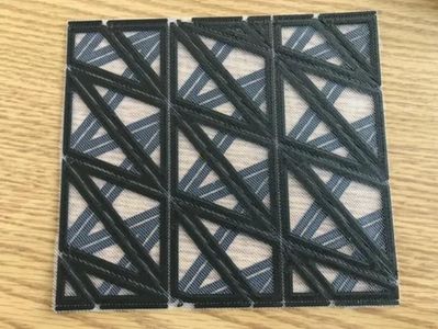

  1. Test the Folding Motion:
  2. Gently manipulate the pieces to ensure they move smoothly along the hinges.
  3. If you encounter resistance or sticking, inspect the hinges and edges for stray material or burrs and clean them up as needed.
  4. Practice the Deployment:
  5. Experiment with the folding sequence to master the movement. It might take a few tries to get everything aligned and working as intended.
  6. For complex designs like the Kresling pattern, take your time to understand how each panel interacts with the others.
