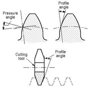

Before you begin it's important to know some of the words used to describe gears. These are all set out in ISO 1122-1:1998, but you don't need to know all of this to print your own replacement gear.
Pressure Angle: angle between the tooth face and the gear wheel tangent
Module: reference diameter of the gear divided by the number of teeth
Helix Angle: acute angle between the gear teeth axis

- The pressure angle is much harder to measure, but most gears either use 20° or 14.5°, so select whichever looks closest to your gear.

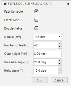

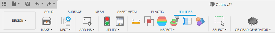

Before starting make sure you have GF Gear Generator installed for Fusion 360.
- Click into the Utilities tab then click on GF Gear Generator drop-down menu to select what type of gear you want to make. You will then be prompted to fill in the desired dimensions.
- For the module, select the value that is closest to, but still less than, the result you found in the previous step.

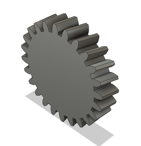

- Fill in all other values and click OK to generate the gear.
- Before going any further you need to double-check that this gear is dimensionally accurate. Click the ruler in the Utilities tab to begin measuring, and compare to its real life counterpart.
- If the diameter of the model is too small, go back and increase the size of the module you chose and vise versa.
- If the gear teeth look too pointy, go back and select a smaller pressure angle.
- If everything looks good you can move on to modifying the gear to fit your needs.

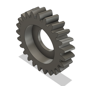

To edit the gear, open the Solid tab and create a sketch on the face of gear, draw the relevant shapes, and cut them out as needed with the Extrude tool. Note that you don't need to replicate the internal geometry to exactly match that of the original part, you just need to be able to fit it in the same place as the original.
Now you can move onto 3D printing.
