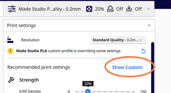

Step 1: Setting Up the Slice in Cura
Make sure you already have a 3D model file opened into Ultimaker Cura. Then make sure the following settings look as they do in the image to ensure Cura is set to Ender 3 Max and the correct plastic for your print (Made Studio default is PLA).

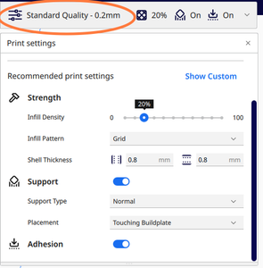

Step 2: Set Your Print Quality
Set the quality of the print to 0.2mm

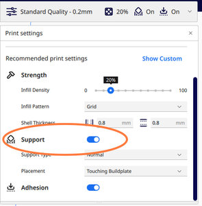

Step 3: You Can Add Supports That Hold Up the Model(optional)
If the model has overhangs make sure that supports are enabled

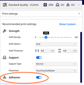

Step 4: You Can Also Add a Base With Set Adhesion(optional)
If bottom of model doesn’t have adequate surface area, enable Build Plate Adhesion.

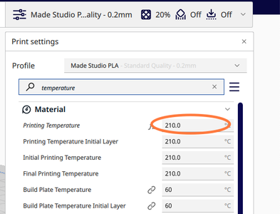

Step 5: Set Your Print Temperature
Ensure the printing temperature is between 205 degrees and 215 degrees. To do this press Custom and then type in ‘temperature’ to the search field. You will see the printing temperature there.
