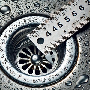

Step 1: Measure Your Drain
The first step is to accurately measure your sink drain to ensure the drain catcher fits perfectly.
  1. Outer Diameter: Measure the diameter of the outer edge of your drain. The drain catcher's base should be slightly larger than this measurement to ensure it sits securely in the drain.
  2. Inner Diameter: Measure the opening inside the drain where water flows through. This measurement will determine the size of the drainage holes in your design.
  3. Depth: Measure the depth of the drain if you want the catcher to sit deeper for more stability.
Taking these measurements ensures your drain catcher will be effective and snugly fit. Accuracy here is the key to preventing food from slipping through the cracks and down your drain.
