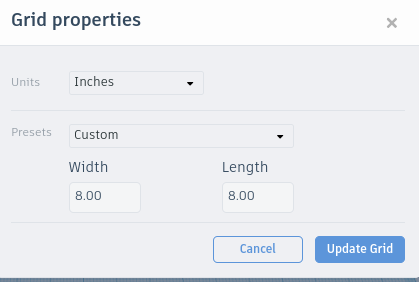

Step 1:
Change the "Properties" to inches and the width and length to 8 inches.

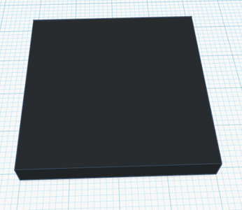

Step 2:
Place a cube with the dimensions 4 x 4 x 1/2 on the workspace. Place a hole cube with the dimensions 3 1/2 x 1 x .05 on the workspace 0.45 inches of the ground. Place a sphere with a diameter of 0.3 on the workspace 3/8 inches of the ground. Make 23 copies of the sphere for a total of 24.

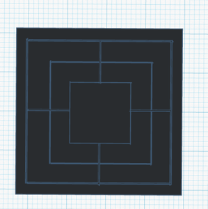

Step 3:

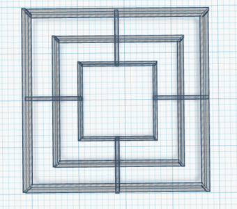

Make 8 copies of the rectangular prism hole. Arrange 4 of them into a square. Group the shapes. Make 2 copies of the square, and make one 1 inch shorter, and the other 2 inches shorter. Center the squares as shown in the left image. With the other 4 original prisms, arrange them so they are centered with each square. Do this on each side of the square (the rectangular prism will be too long, so shorten it to fit).
Group the prisms together. Center the hole on the solid block, and group.
Step 4:
Arrange the sphere as shown in the image, then group the shapes. Print the board.

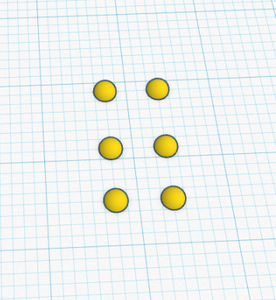

Place a semi-sphere with a diameter of .25 on another workplace, with the same "Properties" as the first one. Make 5 copies (6 total).
Step 6:
Print out 18 semi-spheres for each of the two colors. Glue two corresponding semi-spheres together. After this, you should have 9 spheres in each color.
