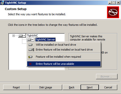

2. In the installation menu, you only want to install the VNC viewer, so in the installation menu, select "custom". Change the selections to what is in the picture above.
