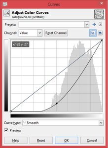

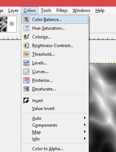

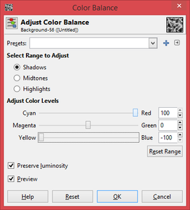

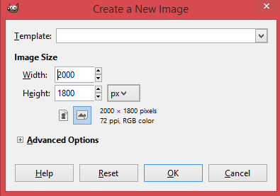

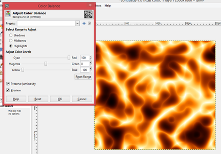

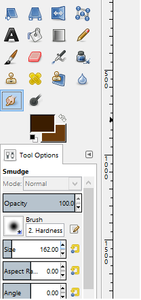

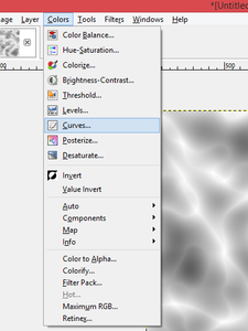

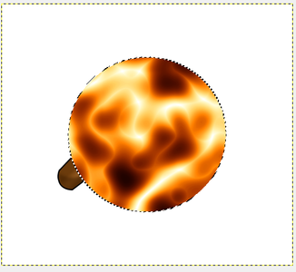

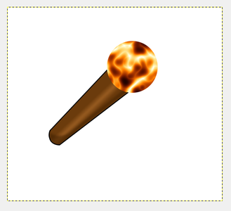

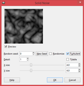

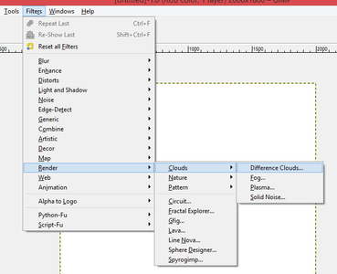

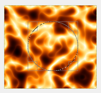

How to Add Flames to Anything in GIMP By LBLuckz in CircuitsArt9,62251FeaturedIntroduction: How to Add Flames to Anything in GIMPThis is how you make somewhat realistic fire in GIMPStep 1: Click "New"Step 2: Set Width to 2000 and Height to 1800Step 3: Click on Filters>Render>Clouds>Difference CloudsStep 4: Check the Box Next to "Turbulent" Then Click OKStep 5: Select "Curves" Under the "Colors" TabStep 6: Move the Curve So It Looks Like This, Then Click "OK"Step 7: Under Colors, Click "Color Balance"Step 8: Click on Shadows, and Set the "Cyan>Red" Bar to 100 and the "Yellow>Blue" Bar to -100Step 9: Do the Same With the "Midtones" and "Highlights" Tabs Until the Picture Looks Like ThisStep 10: Use Any Select Tool, Select a Section of the Picture, and Copy It (CTRL+C)Step 11: Go to the Image You Want to Paste It On, Click "New Layer," and Paste It In.Step 12: Use the Move, Rotate, and Scale Tools to Move the Selection As You Wish. Once Done, Deselect.Step 13: Equip the Smudge Tool and Set the Size As You Wish. (Reccomendation: 160)Step 14: Make Little Strokes in the Fire Pattern Going From Bottom to Top.Step 15: Continue Until Your "fire" Looks Somewhat Realistic.
