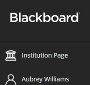

Step 1: Log Into Blackboard
Use provided login credentials to log into the system.
