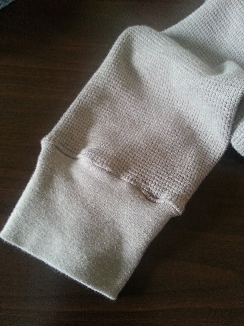

Whether you are making a new garment (shirt, jacket, dress, or even pants) or just want to add a ribbed cuff to a garment you already own. This will show you how to get EASY, professional looking results.
For the purpose of this tutorial I will be using contrasting colors to make my samples easier to see.
This tutorial is using a regular sewing machine, but it will work using a serger (overlock machine) as well

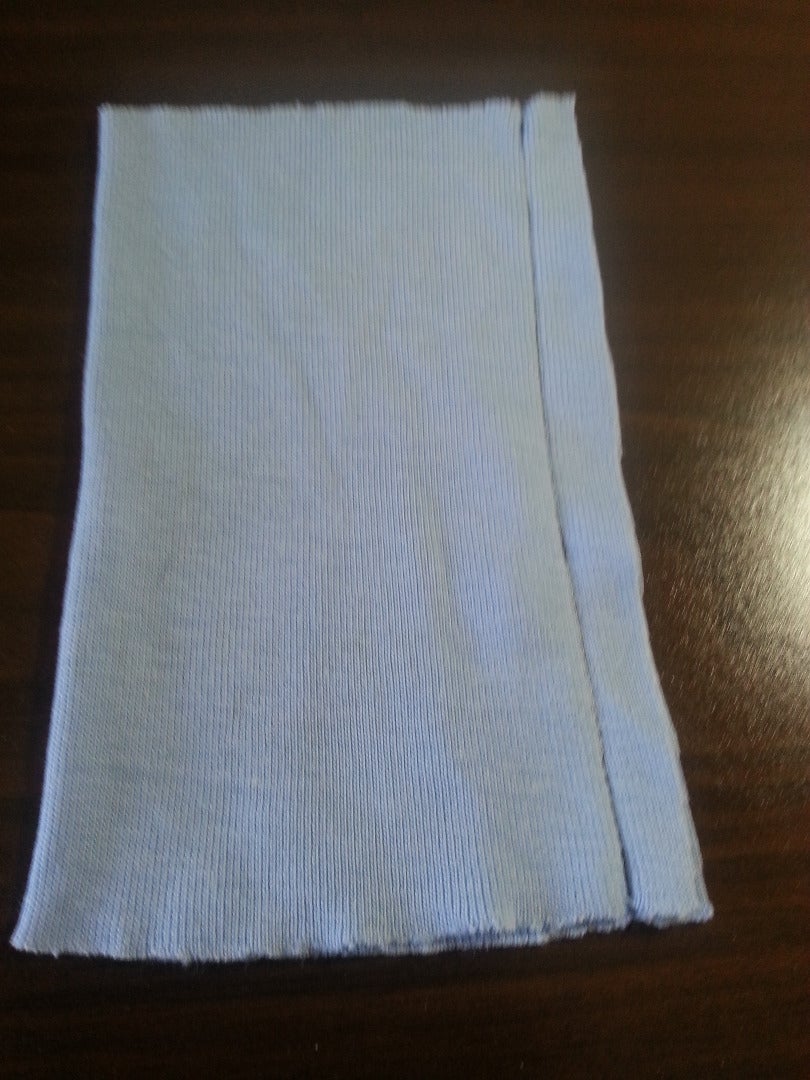

Step 2: Cut Your Ribbing

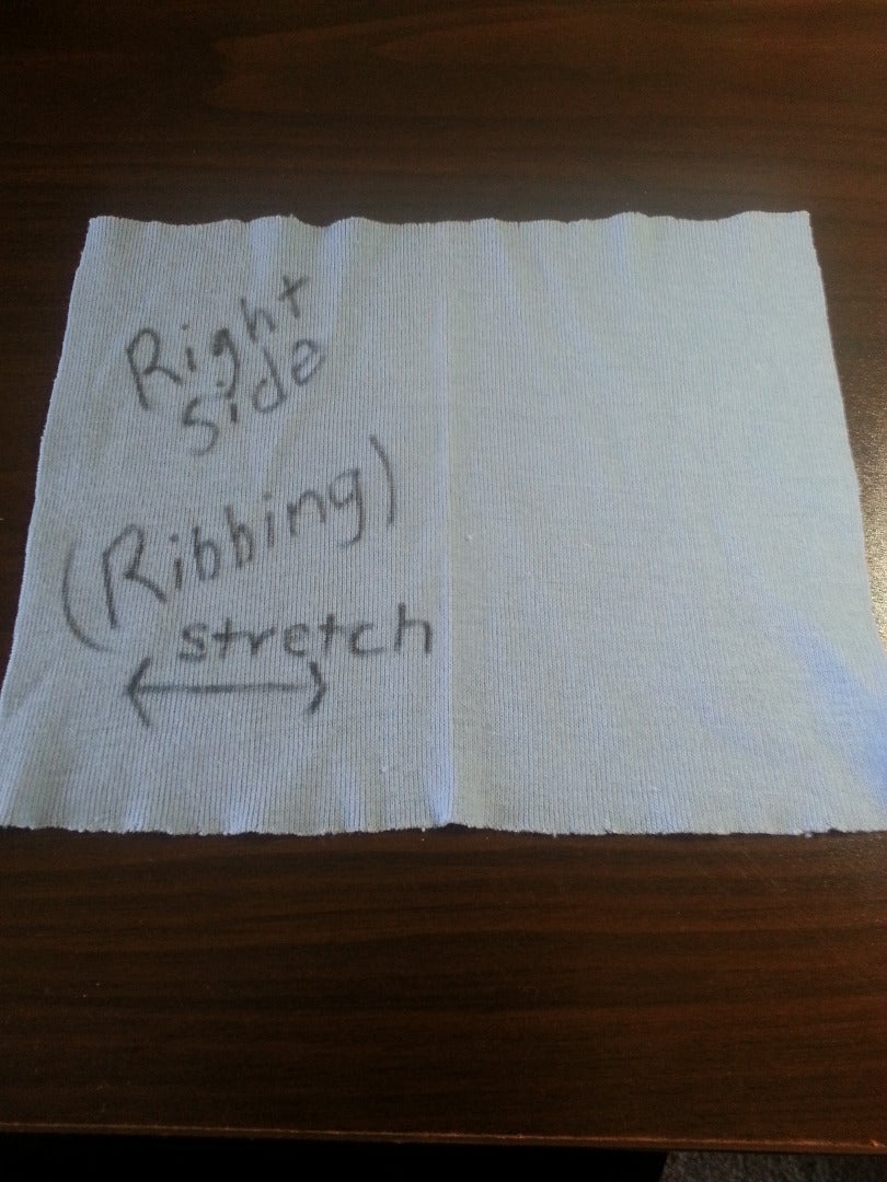

We have determined that I want my FINISHED cuff to be 3" long (and that I need to ADD about 1" for the seam allowance) and that my wrist is 7" (and I don't want my cuff too loose) I will use a 5/8" seam allowance, so I will need to cut each one of my cuffs into a rectangle 8" WIDE (with the stretch of the fabric going around my wrist, so the WIDTH of the cuff) by 7" long. You can make a paper pattern if you wish, or just draw on your fabric with a sliver of soap, chalk or something else that WASHES out of fabric. Determine which side of your fabric is the RIGHT side (the side everyone will see) BEFORE you cut your fabric....make all marks on the WRONG side.
Cut two (2) pieces of ribbing 8" wide X 7" long (we have 2 wrists).........MAKE SURE the STRETCH is along the width (in my case the 8" side)

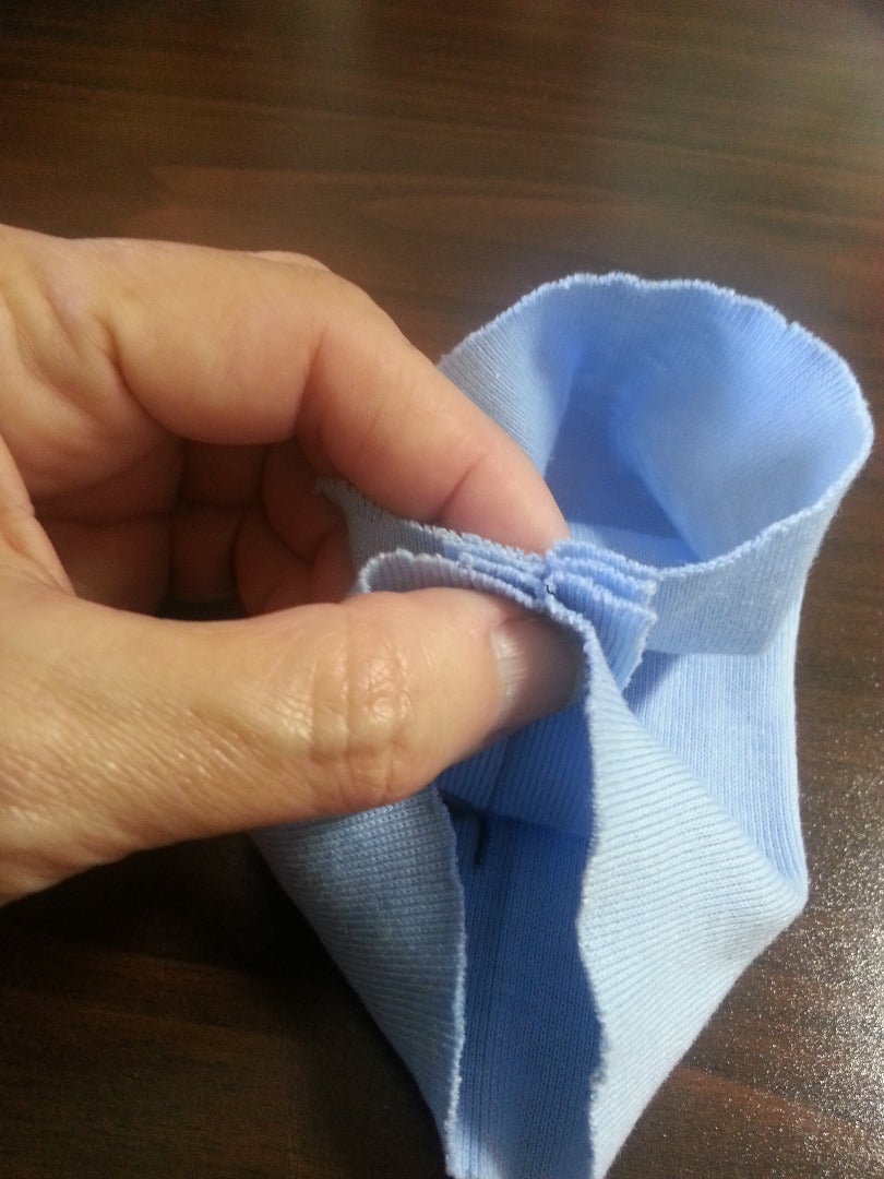

OPEN the seam (as shown in the second pic)
Keeping the seam OPEN all the way down the whole seam, bring the edges together and hold securely between your thumb and first finger.

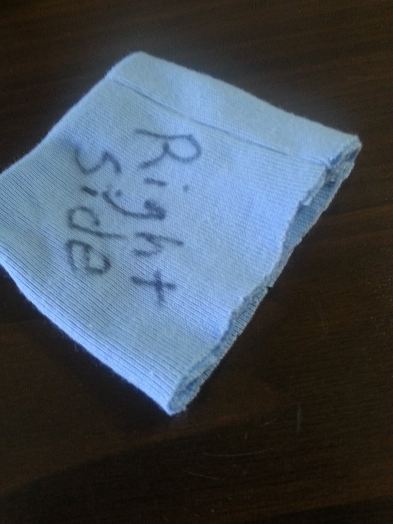

Now (still holding the seam open) using your other hand flip the rest of the ribbing tube over and match up the edges. Look inside and double check that the whole seam allowance is OPEN. Your tube now is turned with the right side out and the cut edges, and seam enclosed on the inside.
Try the cuff on. Adjust to fit by making it looser or tighter before making the second cuff.
Repeat for the second cuff. Set them aside

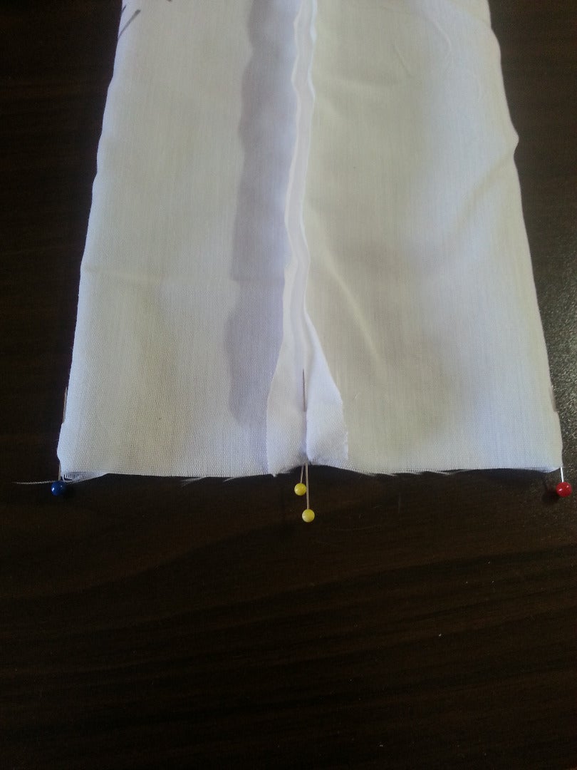

Step 4: "Quarter" Your Sleeve and Cuff

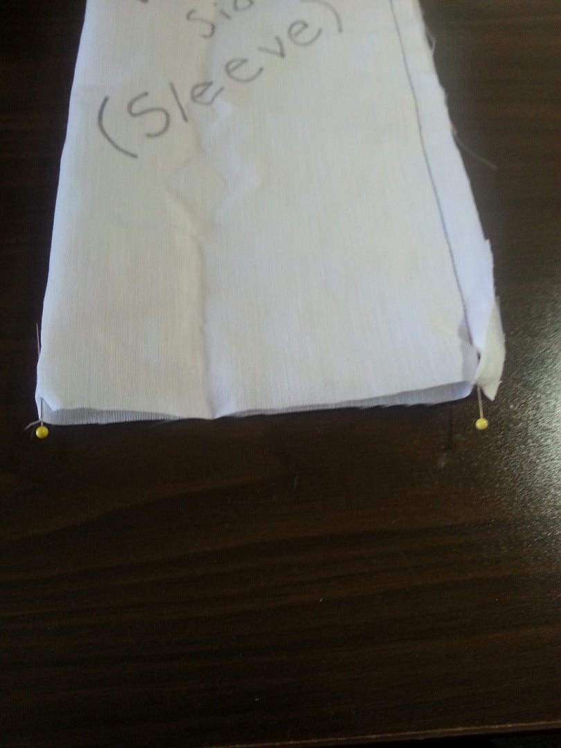

Once you have the underarm seam on your sleeve sewn (with right sides together) DO NOT turn it.....leave it wrong side (inside) out. IF you are adding a cuff to a garment that is already finished turn the sleeve inside out.
Quarter your sleeve:
  • Place a pin through underarm seam
  • Place a pin on the opposite side as shown in the first picture
  • Now match those 2 pins, and place pins in the 2 folds that were created when you matched the pins (see the second pic)
  • Repeat those same steps for the cuffs.....making sure you pin through BOTH layers

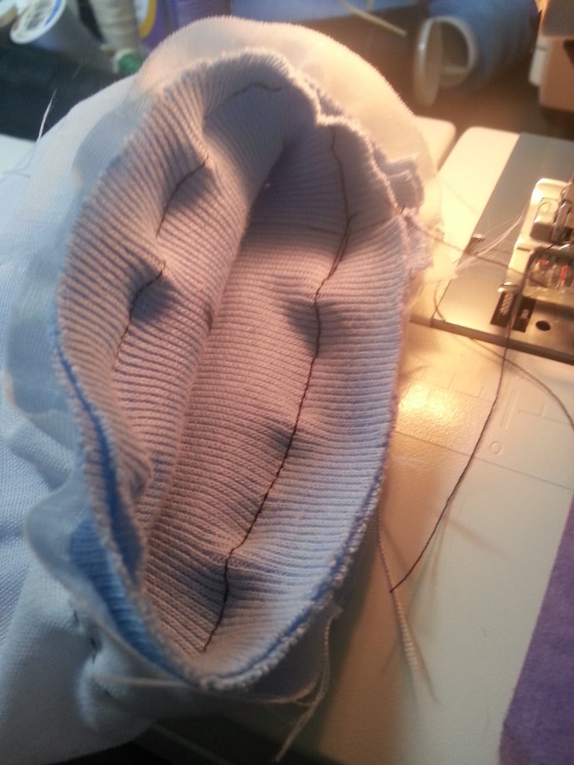

  1. Place the cuff (which is already RIGHT side out) inside the sleeve (which is still WRONG side out from sewing).......This is putting the sleeve and cuff RIGHT sides together.
  2. Line up the cut edges AND the seams of the cuff and sleeve
  3. Starting with the seams match the pins (from the cuff and sleeve).
  4. Holding the seam in place, remove ONE (1) of the pins. Using the remaining pin.....pin through all layers of the cuff and sleeve at the seam. Try to keep the pins in straight.
  5. Move to the next set of pins. Hold the cuff and sleeve in place with one hand. Remove ONE of the 2 pins, and replace it with the remaining pin (pinning through all the layers of the cuff and sleeve)
  6. REPEAT for the remaining 2 pinned areas
  7. You now have 4 pins holding the cuff and sleeve together. It should look something like the second picture

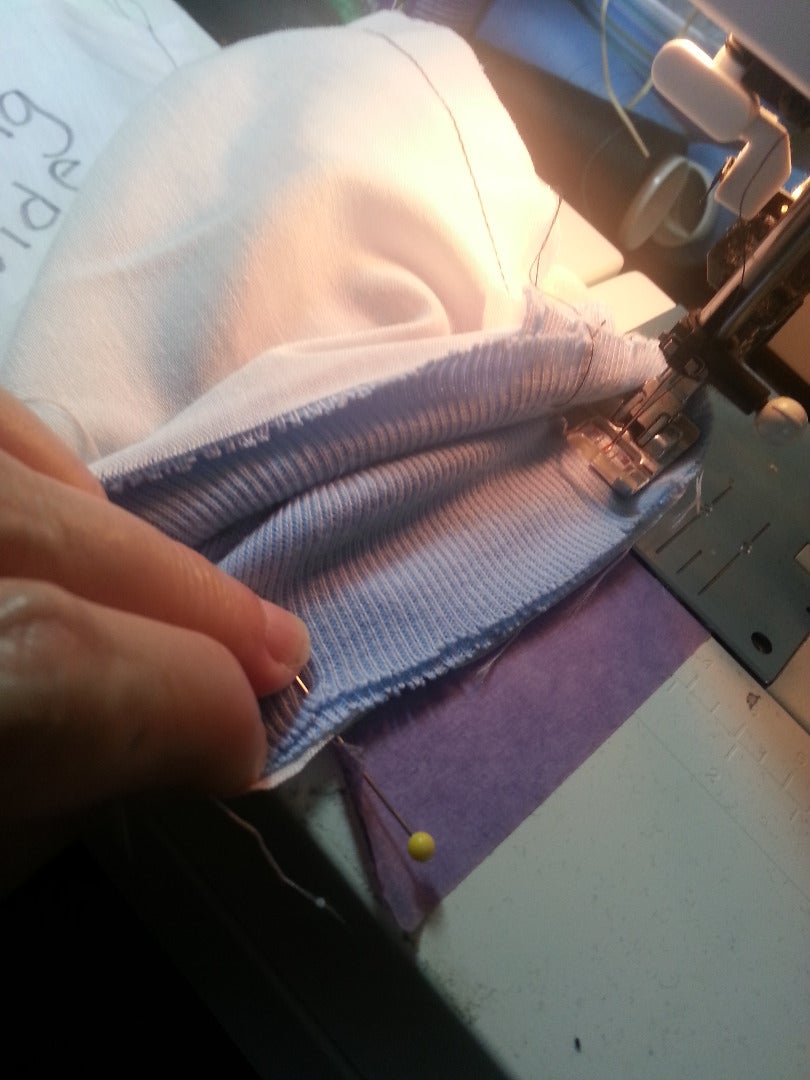

You will be sewing on the INSIDE of the cuff, with the ribbing facing UP. You will stretch the ribbing to fit the sleeve, and you will be sewing from pin to pin.
PLEASE NOTE IF your sewing machine has a 'Needle Down' feature this is a great place to use it. IF not whenever you stop (before removing the next pin) put the needle DOWN to hold your fabric in place. Do NOT sew over pins.
  1. Line your cuff and sleeve edges up, and place the needle in the down position close to the first pin.
  2. Remove the first pin
  3. Stretch the ribbing to fit the sleeve to the next pin.
  4. Sew with your chosen seam allowance (mine is 5/8") from pin to pin
  5. Overlap the beginning stitches when you get all the way around
  6. Repeat for the other sleeve

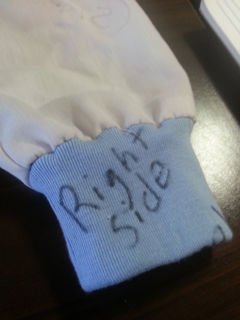

Step 6: You Can Stop Now OR Finish the Edges
IF you are sewing with knit fabrics, you can stop now. Depending on what size seam allowance you used you might want to trim the seam so you only have 1/4-1/2" left......it just looks neater.
OR
You can TOP STITCH the seam allowance down to the sleeve side (using a longer stitch). Picture #1

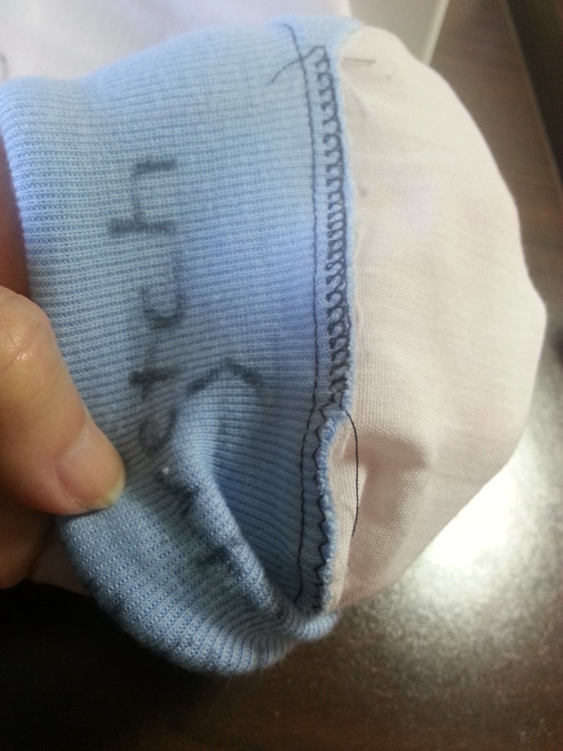

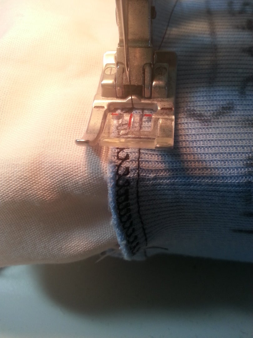

You can finish the seam allowance with either a zigzag stitch or another stitch (depending on what stitches your machine does) (picture 2 shows 2 different stitches) stitch close to the original stitching line.
Trim off the excess (pic #3)
Now you can TOP STITCH this down to the sleeve side with a longer straight stitch close to the seam line.
