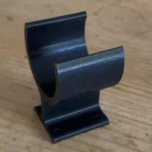

Step 3: Mount the Smoke Grenade to the Aircraft
Now that the smoke system is ready, attach it securely to your RC plane.
- Option 1: Use strong tape to affix the grenade to a stable surface (e.g., wing underside or fuselage, or undercarriage).
- Option 2: Use a 3D-printed bracket such as https://www.thingiverse.com/thing:7140509 for a cleaner, more secure install.
Make sure it is balanced, and the COG is the same and doesn’t obstruct control surfaces.
