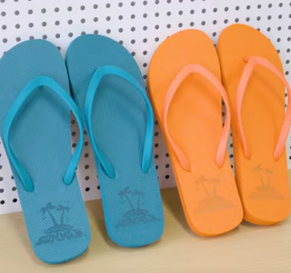

Let’s bring a touch of personal flair to your summer look with laser engraving flip flops! These lightweight, beach-ready essentials come to life with precise, lasting engravings. Whether it’s a playful graphic, a favorite phrase, or a custom pattern, each detail turns your everyday footwear into a statement of fun and individuality.
Ready to step into summer with style and personality?
Machine Used
Thunder Bolt 30W
Material Needed
EVA flip flops
Engraving
  1. Speed: 300mm/s
  2. Power: 80%
  3. DPI: 335
  4. Air pressure value: Low

When the custom flip flops laser engraving is completed, it’s time to get it out. Laser engraving does not produce toxic substances, and you can wear the flip flops after a simple cleaning!
