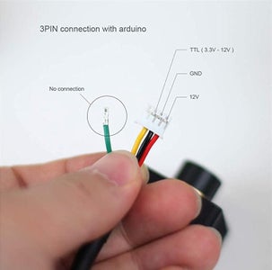

    This should work for all Creality boards and likely many others. Solder a wire to the exposed 5V part cooling fan control pin as shown. I've used this on the original CR-10 board, V1.1.5 and V2.2.1. Be sure to connect a 100 ohm current limiting resistor between the MOSFET and the laser. This will simulate the load of the cooling fan and protect the board. Also route this wire to your connector at the hotend.

    I cut one of the JST connectors off the end of the laser cable, and replaced it. I connected the matching connector to the wiring from the printer.
    Alternately, you can cut one end of the laser cable and wire directly from the printer to the laser cable. I chose not to because I wanted to connect/disconnect the laser farther from the hotend.
    Make the connections as shown in the picture. If you have a fourth wire, it's for laser temp and you can leave it unconnected.
