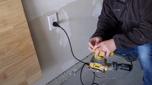

Step 7: Test
Plug something into your new outlet and test.
You did it! Congratulations on having more outlets!
