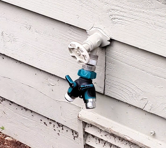

Step 1: Install a Two-Way Splitter
You can choose to install a two-way splitter on your outdoor faucet. One side will go to the new spigot, and the other can stay connected to your existing hose.

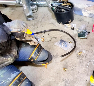

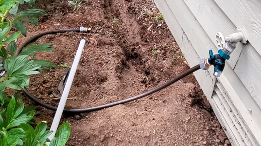

Step 2: Connect the Lead-In Hose
Connect a lead-in hose from the faucet to the start of your PVC pipe route.
You can choose to purchase a lead-in hose or make your own by cutting an old garden hose and adding repair connectors. You just need to purchase the garden hose repair connector & fittings. The advantage is that it is cheaper, and you can customize the length to fit your layout.

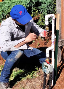

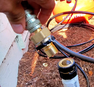

Step 3: Install a Quick-Release Connector
I recommend installing a quick-release connector. That way, you can easily switch it out for an air compressor adapter during winterization. If you skip this step, you’ll need to unscrew the fitting manually when winter comes.

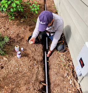

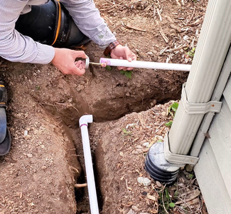

Step 4: Dig a Trench
Digging the trench was the most time-consuming part of this project for me, but it was necessary for cold-weather protection.

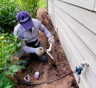

Step 5: Connect PVC Pipe
This is the main step of the project. You’ll be connecting and routing the water line by running PVC pipes from the original faucet to the new spigot location. Use 90-degree or 45 degree elbows, connectors, primer, and cement to glue the pieces together securely.
Using Primer And Cement
Here’s how to use the primer and cement:
- Apply primer to both the pipe and fitting.
- Wait about 10 seconds for the primer to soften the surfaces.
- Apply cement to the primed areas, insert the pipe into the fitting while rotating slightly to spread the glue evenly.
- Hold for a few seconds, then let it cure for at least 30 minutes before turning on the water.

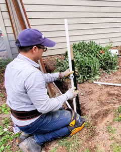

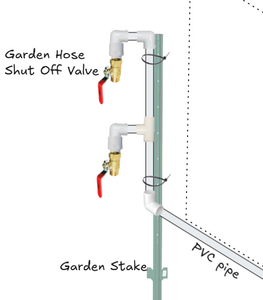

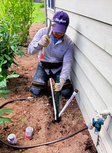

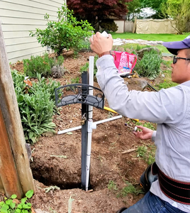

Step 6: Install the Spigot
This is almost the last step of the installation. Connect a vertical PVC pipe, and use a couple of 90-degree elbows. Then use a male threaded fitting and finally a shut off vale that can connect to a garden hose.
Moreover, you can use tee fittings if you want more than one outlet.

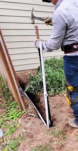

Step 7: Support the Pipe
While you are installing the vertical part of the pipe, you want to support the them by driving a garden stake into the ground, or you like, dig a hole, pour concrete and set a wooden post in concrete. Then secure the PVC pipe with the stake or post.

- Disconnect the lead-in hose from the pipe—or if you installed the quick-release connector, just pop it off.
- Attach a garden hose-to-compressor adapter and connect your air compressor.
- Power on the compressor, open the shut-off valve, and blow air through the pipe until most of the water is out.
