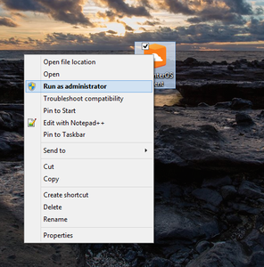

Step 5: Grant Permission
Your computer may or may not ask permission again for you to run 3DPrinterOS. Go ahead and input your administrator password to grant permission to 3DPrinterOS.
NOTE: If you are using windows you will need to open 3DPrinterOS with administrative privileges. You can do this by right clicking the 3DPrinterOS application on your PC and selecting "Run as administrator" as seen in the image here.

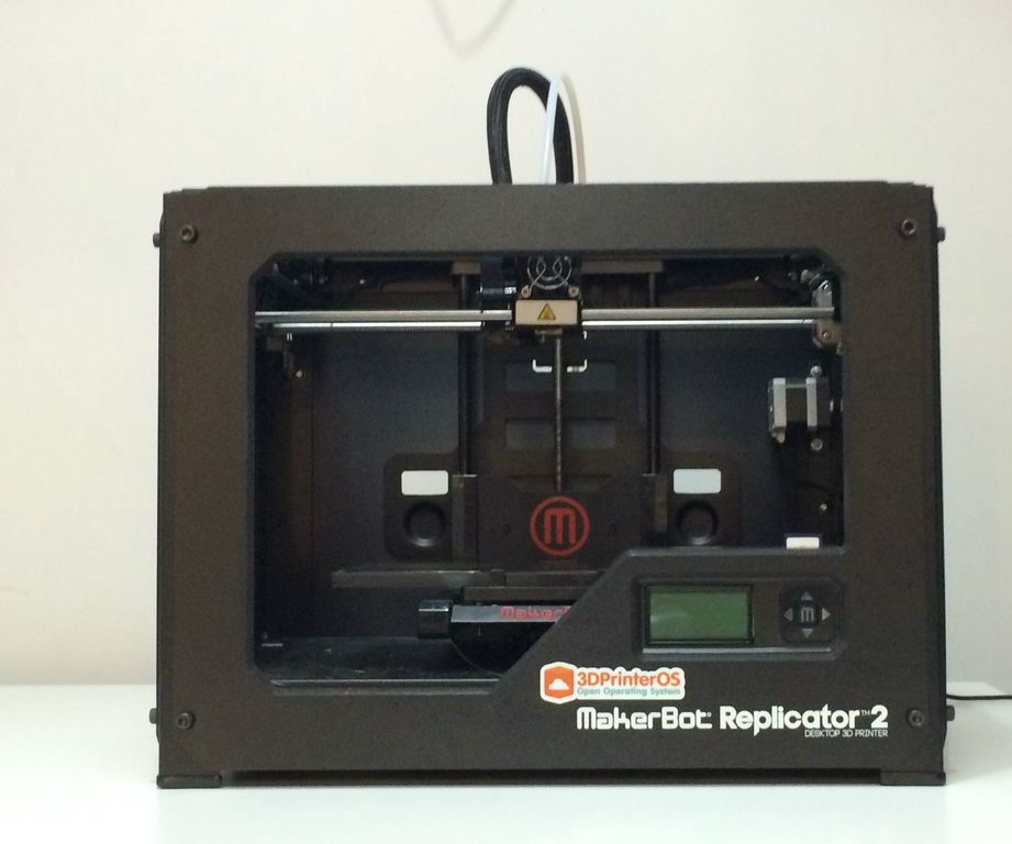

Step 6: Make Sure Your Printer Is Connected Via USB and Log in Again
3DPrinterOS may ask you to log in again before entering the system. This is to make sure your printer is synced to the right account. (Some people share printers or have multiple printers).
You will only have to do this one time and from here on out the system is plug-and-play meaning, once you are logged in and the printer is online you should be able to simply plug your printer in and you will be up and running.
Step 7: 3DPrinterOS Should Now Recognize Your Printer
Your printer should appear as recognized by 3DPrinterOS. From here go ahead and select "Go to your account now".
If you have any issues with the printer being recognized, cycle power on the printer.
