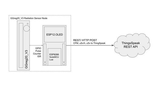

F2. GGreg20_V3 Radiation Sensor Node data flow to ThingSpeak

So, we have an ESP12.OLED module with NodeMCU firmware and developed Lua code and a GGreg20_V3 sensor connected to it, which already works with the ThingSpeak service.

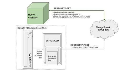

Step 1: Information Flows
So, on the one hand, we have a functioning sensor that is already transmitting measurement data to ThingSpeak, and which we cannot or do not want to interfere with. On the other hand, we have the Home Assistant server to which we want to connect this sensor.
This can be done thanks to the possibilities provided by the ThingSpeak service. A diagram of the data traffic is shown in the following Fig.3.
F3. Data Flows: Home Assistant – ThingSpeak HTTP GET Request/Response

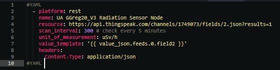

Step 2: Implementing the Task in Home Assistant
The Home Assistant server has all the necessary mechanisms and tools to implement our task. The connection of the virtual sensor to the data in the cloud is solved in a few configuration lines in the server file /config/configuration.yaml:
#YAML
  - platform: rest
    name: UA GGreg20_V3 Radiation Sensor Node
    resource: https://api.thingspeak.com/channels/1749073/fields/2.json?results=1
    scan_interval: 300 # check every 5 minutes
    unit_of_measurement: uSv/h
    value_template: '{{ value_json.feeds.0.field2 }}'
    headers:
      Content-Type: application/json
#YAML
