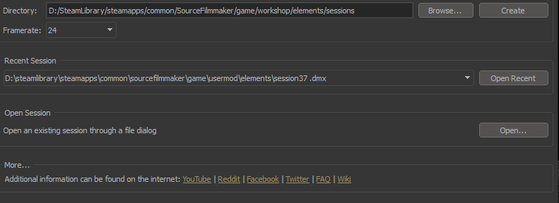

After being greeted with the screen above, create a new session by clicking the button. Then, right-click on the black screen that says "NO MAP LOADED", and select load map. From here, type in the name of the file from the map we downloaded earlier, and open it. This will give us the setting for the animation.

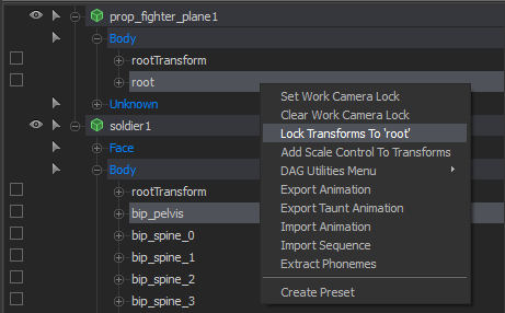

Of course, we want our pilot to stay in the vehicle. That's why we're going to lock his model and the plane's together. To do this, we move the pilot so he's sitting in the plane how we want him. After doing so, we go to the animation editor, select the pelvis bone for the pilot, and hold CTRL while selecting the plane's root bone. Then, select "Lock Transforms to 'root'". Now, the pilot will stay in the plane while it's moving. Before we get started, we want to animate the propeller. Do this by rotating it in circles for 20 seconds after hitting the space bar, and hitting it again when done. Now, it will stay moving for the next 20 seconds.

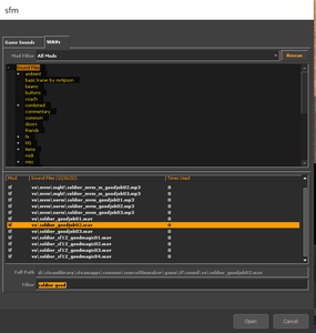

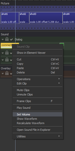

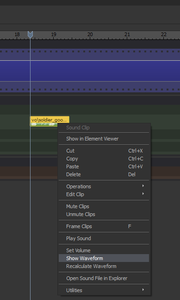

To add sound effects, go back to the film editor, and select the time when you want to add one. Hover the cursor above the "dialogue" channel and right-click to add a sound. Now, you have access to SFM's whole pre-installed sound base. Here, you can find a lot of sound effects for this animation. Find a rubber impact sound when the plane is landing, and insert it. Do this for the pilot's voice as well, which I used the "soldier" voice lines for. If we want our pilot to talk, we simply right-click on the sound to show the waveform. Then, right-click on the soldier model in the Animation set editor and extract the pheromones for this line. If there are more sounds you want to add, go to https://pixabay.com/ to get more. You can then move the audio file into the folder by following the path in File Explorer in the image above. Ensure the file is .wav, otherwise you might not hear it in the editor. You can then set the volume to show that the plane is far away when in the first scene. If you have complications with this step, add them to another video editor after exporting the file. To export your animation, go to file, and select Export. You will find the file by referencing the output path(which you can change) above.
