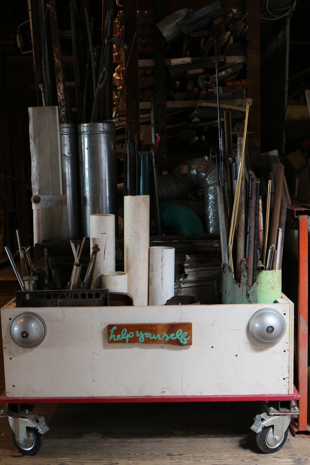

Step 2: What Is 'Collection'?
The museum still houses every bit of material that was in the thrift store when it closed in 1997, nothing new comes in - and nothing old leaves. That makes up the museum's collection. This is not limited to thrift store products, building parts, etc. If it's there, IT STAYS.
There are lots of ways to work with the collection, but there is also some ground rules.
nothing can be permanent! Fasteners on everything, glue nothing! I very rarely cut fabric unless it was ABSOLUTELY NECESSARY
collaborate: with other residents, with the materials at hand, start a dialogue with EVERYTHING

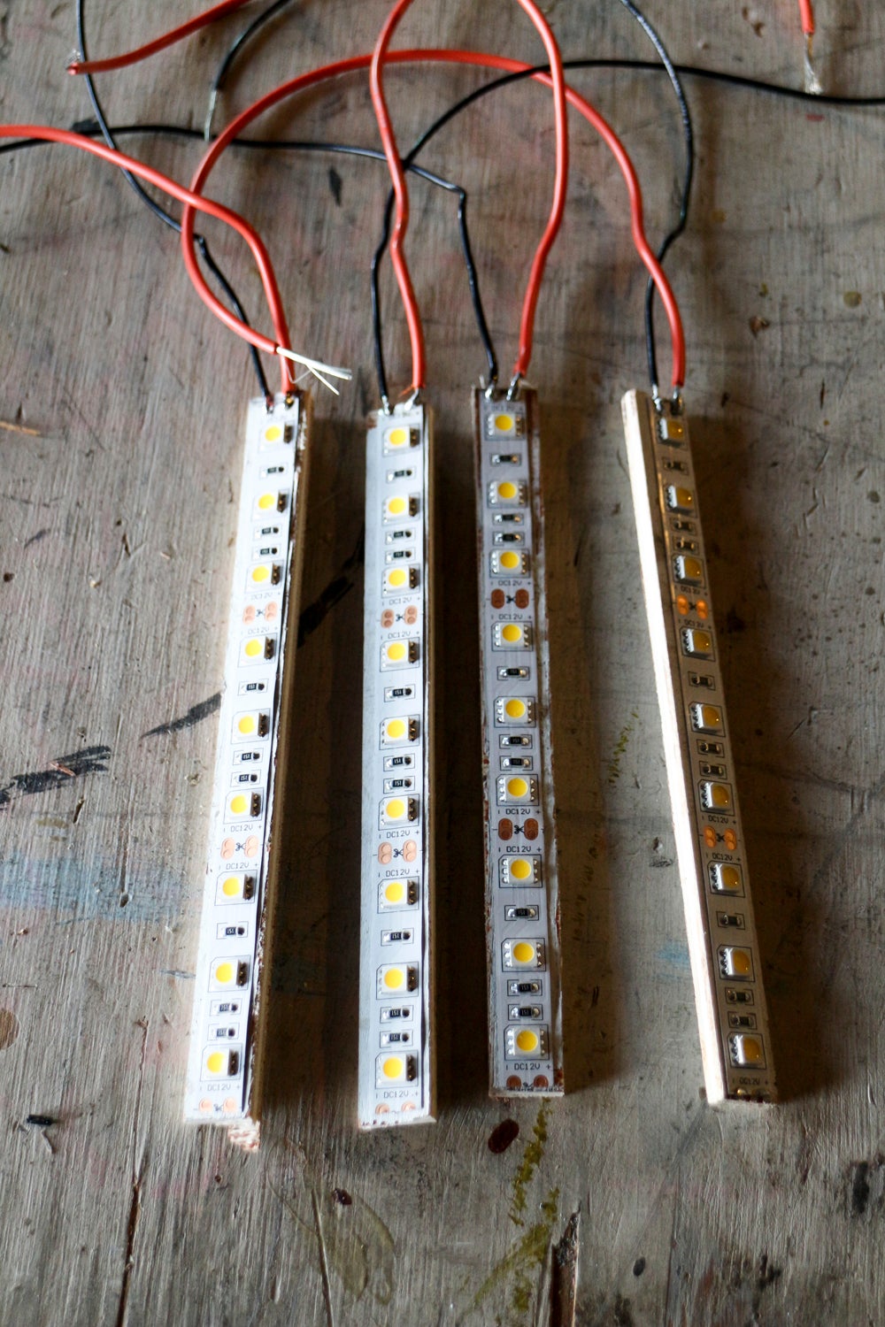

I found a short dowel, and sanded the paint down a bit with 150 grit sand paper. I thought this may help the LED strips stick a bit better to it, but ultimately the adhesive on the LED strip kind of blows. (Thank heaven for zip ties.)
I cut the lengths of LED strips down to a length that would fit on the dowel rod and moved on to wiring.
Step 7: Prototyping the Light: Wiring
I took all the wired ends from the LED strp and connected all of them in parallel. I found a slightly thicker gauge wire and connected all of them into two lines, positive and ground, to run back to the barrel plug connector that came with the LED strip kit.
Two quick solder joints, a little bit of heat-shrink, then I was ready for testing.

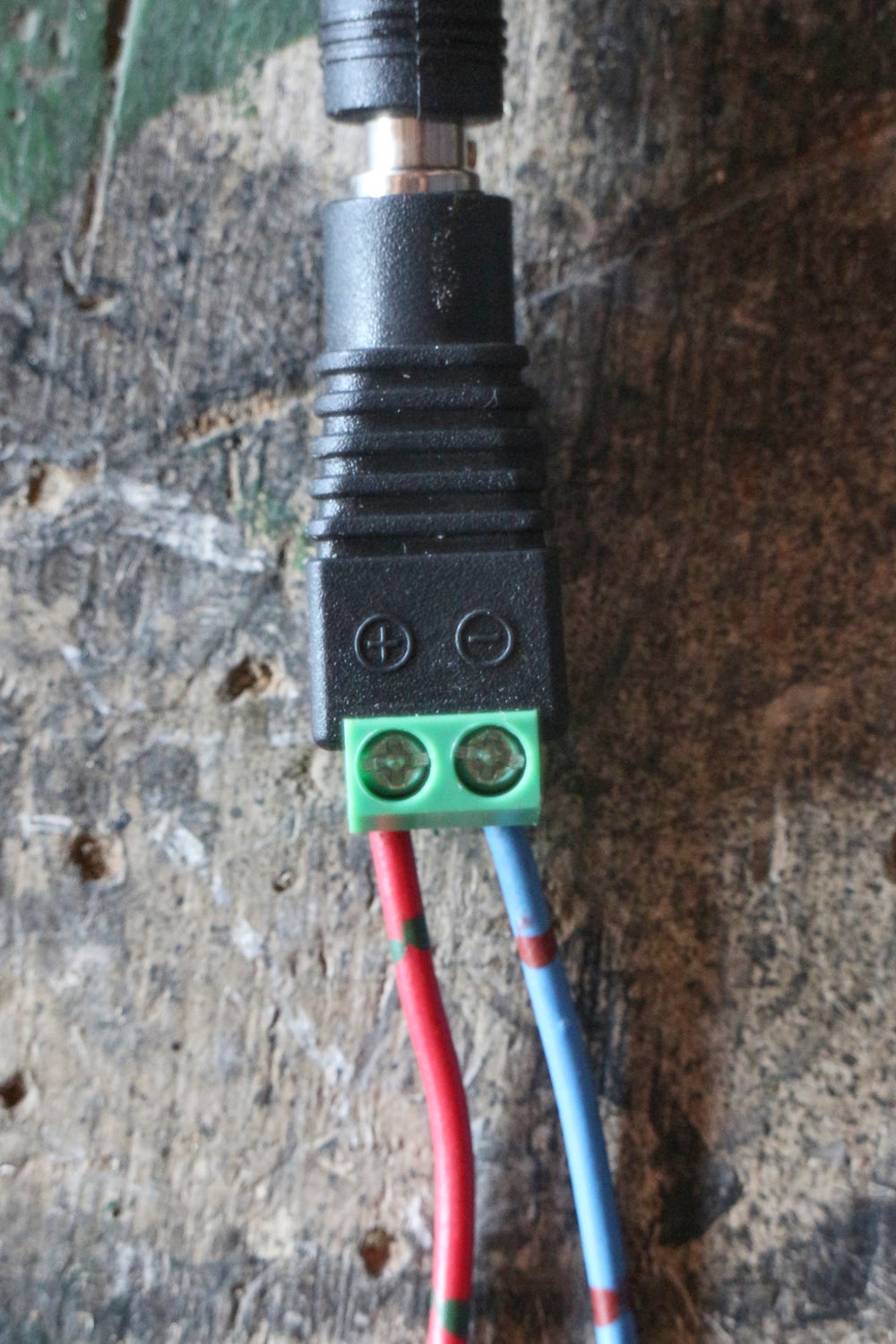

The barrel plug connector that came with the kit is pretty cool. I had never used one like this before, but decided it was totally rad. It has two marked screw terminals to insert the wires into, and then clamps down on them. Pretty cool way to do quick testing.
Alas, it worked!

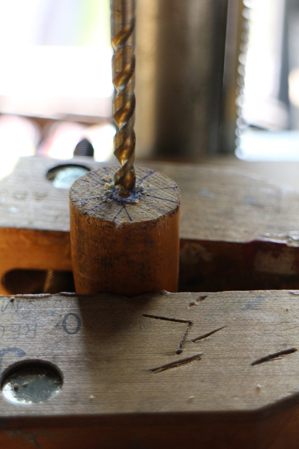

I found a piece of what I suspect used to be a furniture leg, or maybe a broom handle. It had a tapered edge and was a very dense wood.
I did some lackluster center-finding, then clamped it into the drill press to punch out a hole large enough for all the wires.

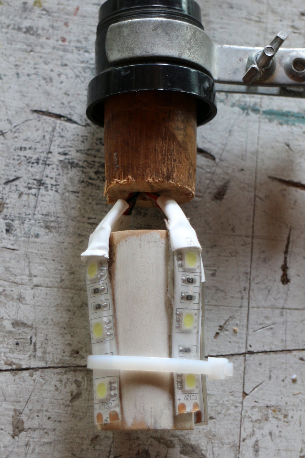

Step 10: Prototyping the Light: Attaching to the Clamp Light
Zipties are your friend. No, really.
The circumfrence of the clamp light was a little bit bigger than the dowel I had made the wire chase through. I faked a tight tolerence by using a zip tie on the tapered part of the dowel to prevent it from sliding though.

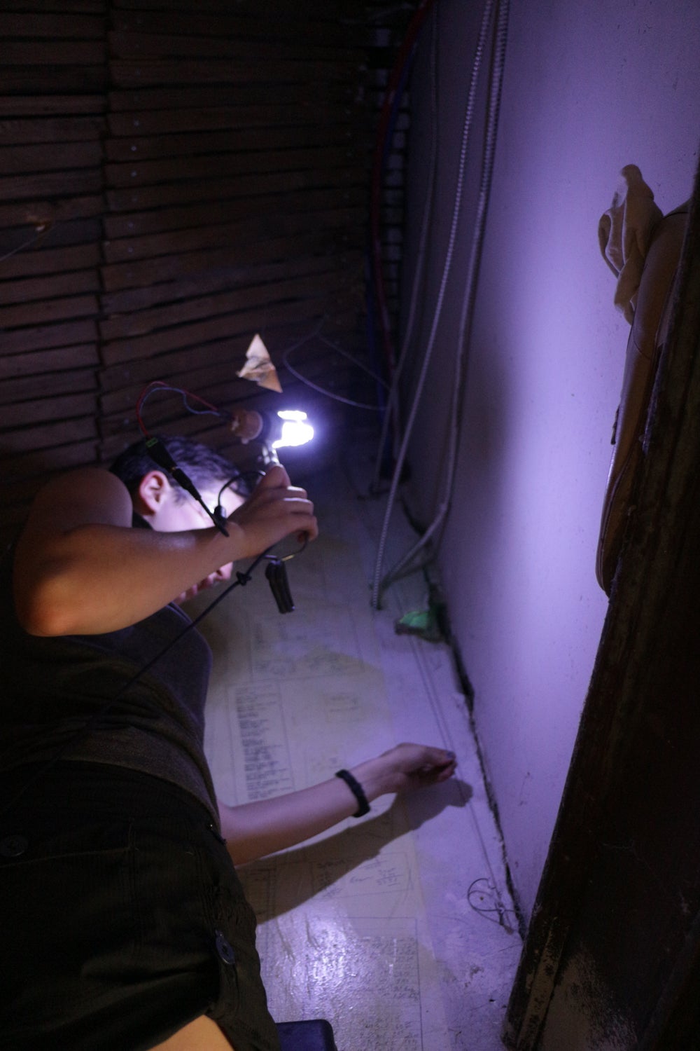

Step 11: Prototyping the Light: Practical Application
I went to my proposed installation space - the stairwell between the 1st and 2nd floor - and clamped the light to the hanging lathe sculpture "Vertical Displacement" by Christopher Moore. I plugged the DC adapter into the wall, and examined the quality of light in the space.
Overall I was pleased with its luminosity, but the color temperature of the lights pushed me to ultimately order Warm White LED strips.

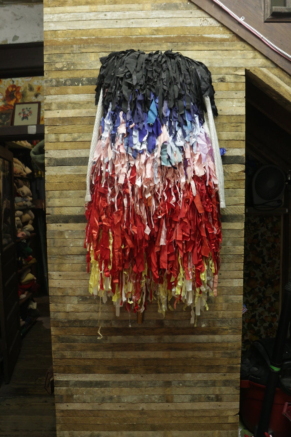

Step 12: Deinstall
Courtney and I hung out on ladders for a bit and took down the sculpture that was there. It was a bit unweildy, but it came down with out personal harm, or harm to the work. HIGH FIVES ALL AROUND!

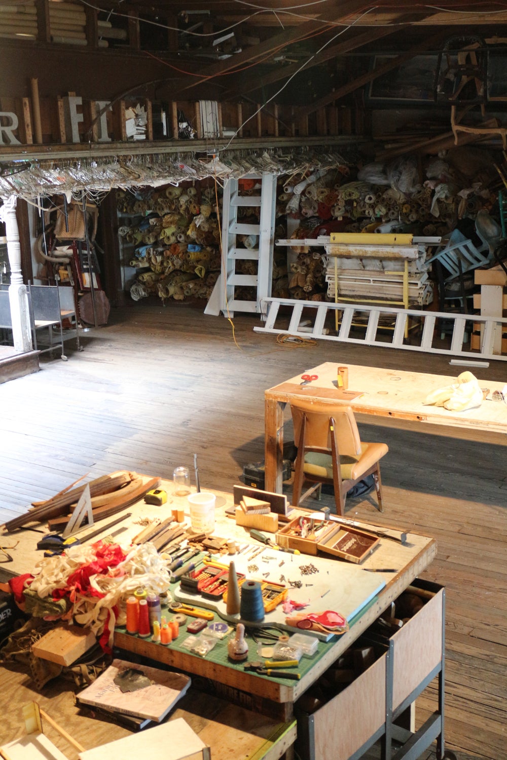

Step 14: Cleaning and Planning
I cleaned up a little spot for myself to map out how the lamps could potentially hang. I applied low-tack blue masking tape to the floor that matched the dimensions of the proposed installation site. This was a good way to meditate about what I could make in the space before I got to work.
(inevitably, I ended up moving away from my original plan, Elsewhere is a space where artists come to be responsive to their environment - I allowed particular pieces of the collection to indicate where my work should go, and how they could be re-curated into the museum)

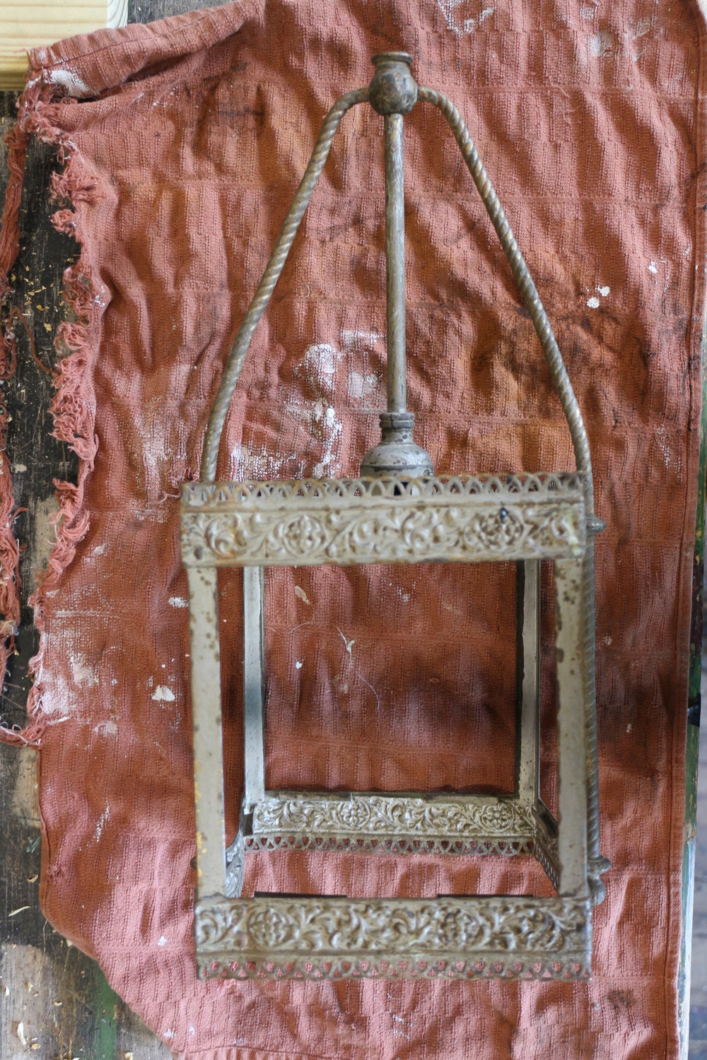

Step 15: The Box Lamp: Finding and Cleaning
I found this really excellent piece in the metal scrap bin of the collection, and ideated a bit with it while I cleaned it up. The Elsewhere (House)pitatlity crew makes a mean all purpose cleaner that was perfect for shining up this old bit of brass with a wire brush.
It smells of vinegar and herbs but works just like Simple Green.
10 minutes of scrubbing, and a quick wipe down with a rag, then it was ready.

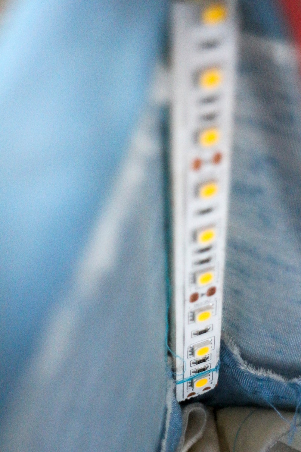

Getting good photos of this part was near impossible, so excuse the extreme close ups. It was hard to jam a camera into the lamp.
I offset the LED lighting strips at a 45 degree angle to the corner. All the filaments were facing the center. I sewed them to the corners with the same thread that I used to adhere the fabric to the form. I extended the wiring and plumbed it up the center ballast.

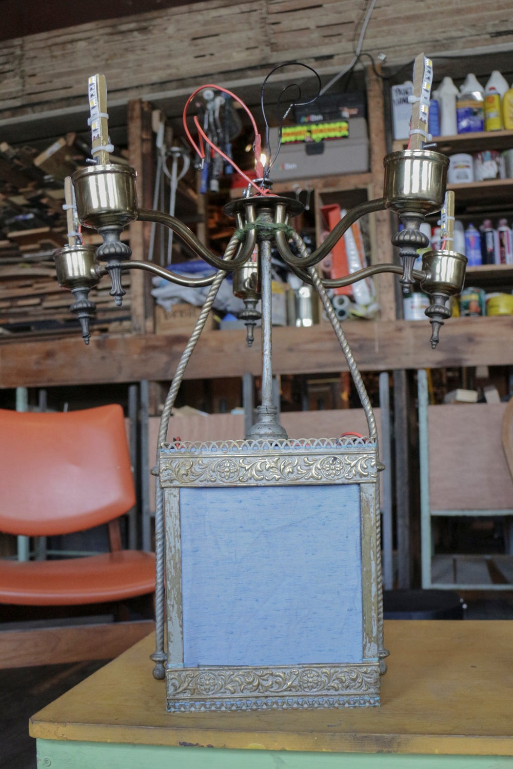

Step 20: The Candelabra: Finding It
I found this 5-point candelabra lamp in the Collection - It was in pretty rough shape when I found it, the wires had been junked, light bulbs had broken off from their sockets, there was even dead bugs in it....ugh.
I knew it was a good form to work with, and it was really light weight. So I got to sprucing it up.

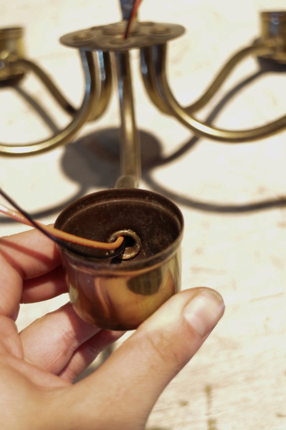

Step 21: The Candelabra: Gutting It
First, I took out all the old lamp parts, and figured that I only really needed the candelabra bulb ballast brackets (say that five times fast?). Each one had a base that it screwed into to fix it to the candelabra. It came apart really quickly.

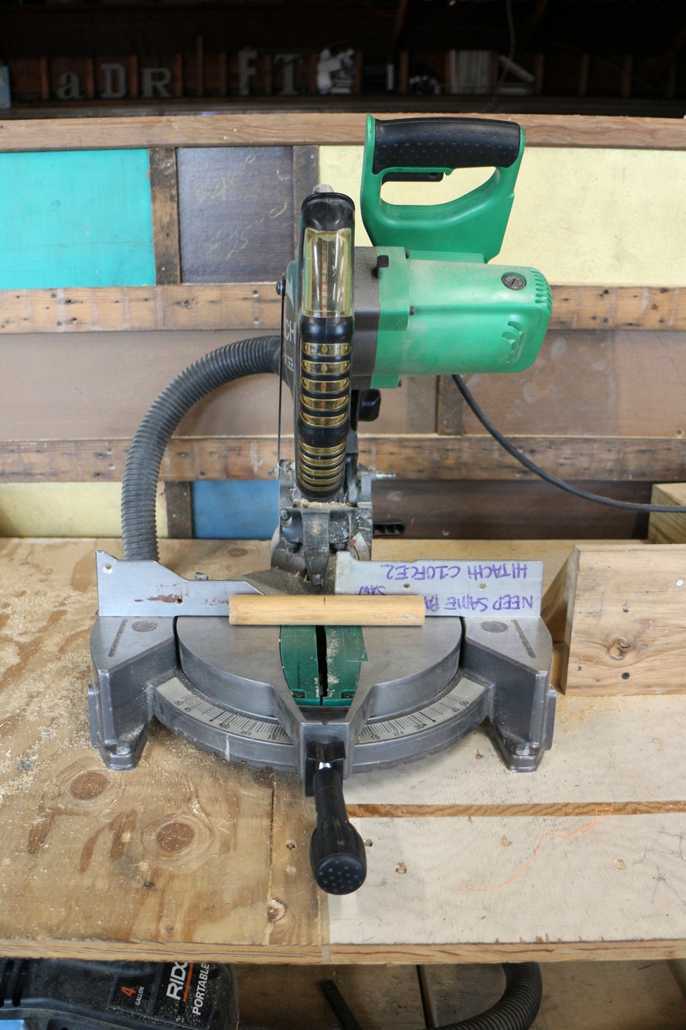

I found a piece of wood, that I suspect to be part of an old drawer set, and cut it into five 3" pieces. These would become the structural part of my new light bulbs.

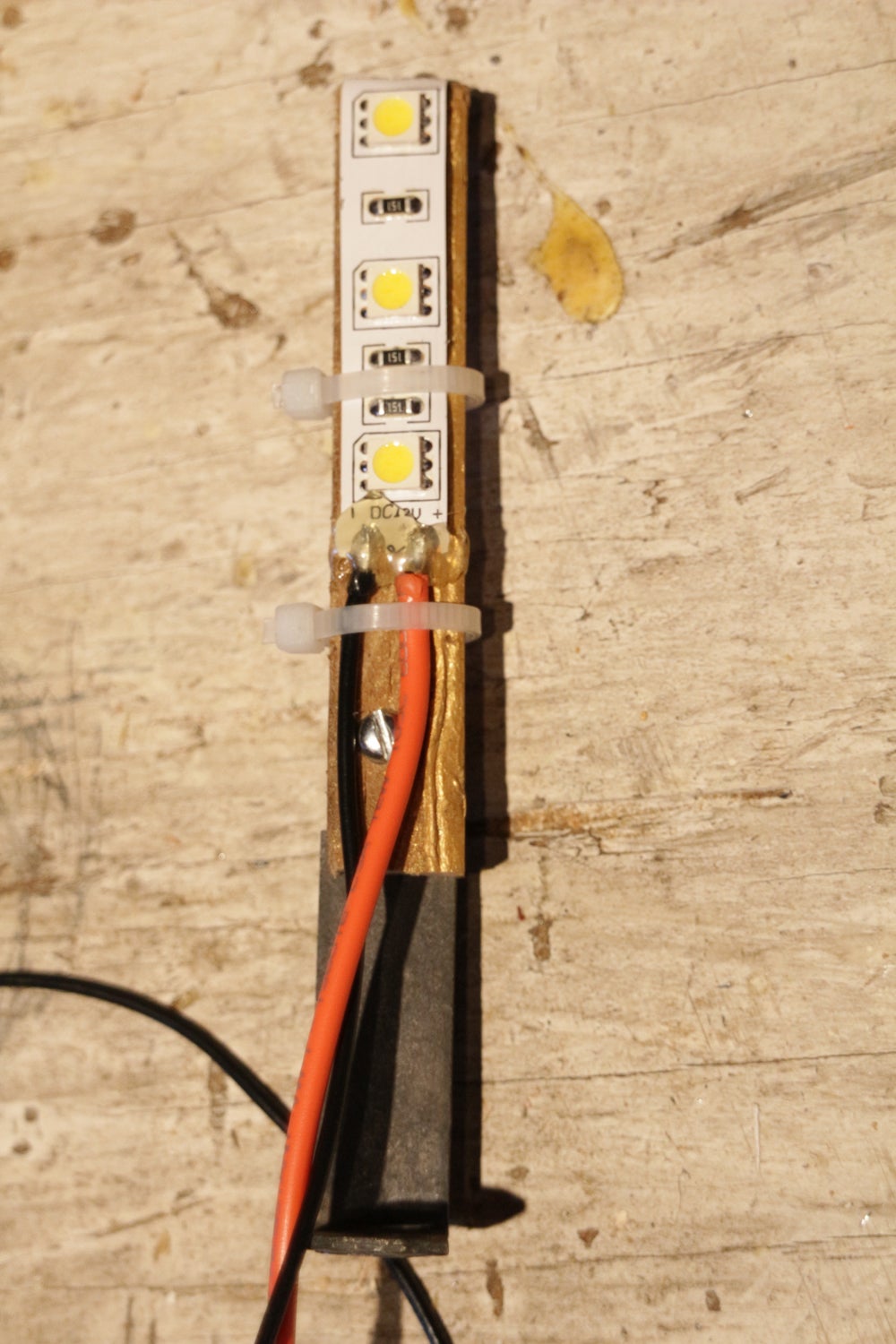

Step 24: The Candelabra: Making New 'Light Bulbs' Pt. 3

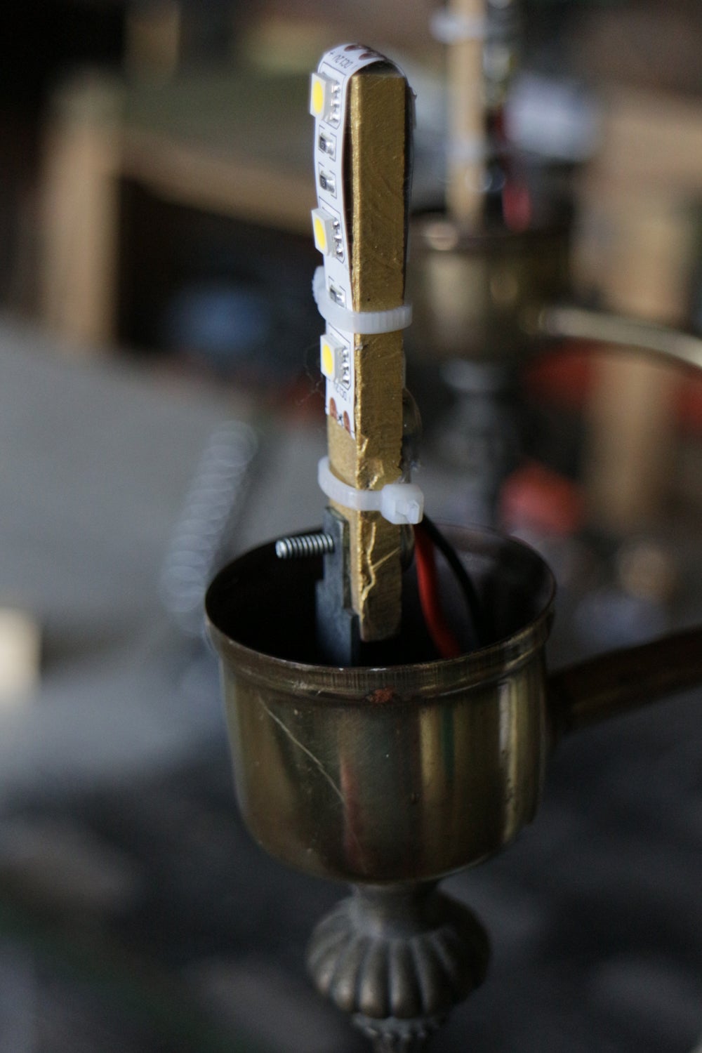

I was able to fit two sections of LED strip onto each little wood piece, and fixed it in place with the adhesive part from the LED strip, and a zip-tie.

Initially, I intended to use the wire that was in the lamp - but after a few solder joints, the wire insulation started to crack. Who knows how old it was, I decided that it was safer to use wire that I had purchased.
I used 18 AWG stranded wire - it is flexible, and can still take a fair amount of amperage, even though this project didn't really need it, I decided to error on the safe side by using slightly thicker wire.

After I had plumbed the new wire into the piece, I re-connected the lamp brackets with the new wooden 'bulbs' into place. A few quick solder joints on each lamp, a dab of hot glue to prevent wire tear-out, and I was ready for testing.
Step 27: The Candelabra: Common Junction
I wired all five candelabra points into one common junction, then sealed it with some heat shrink. It worked great.

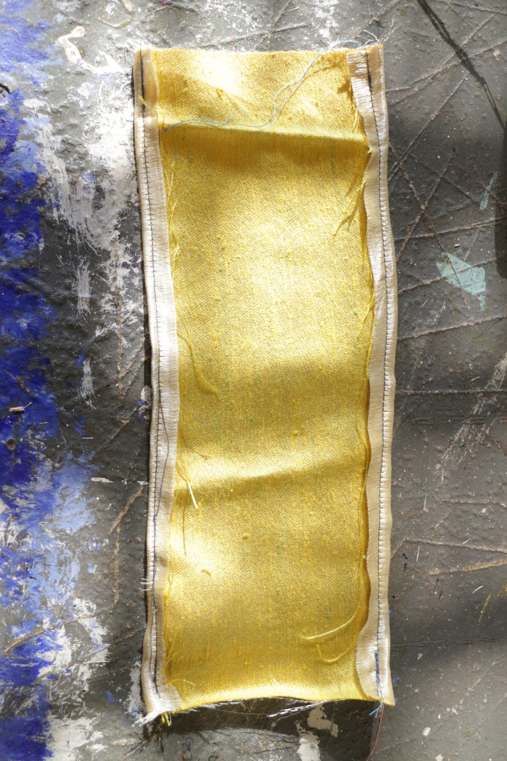

Step 30: Sewing the Lampshade

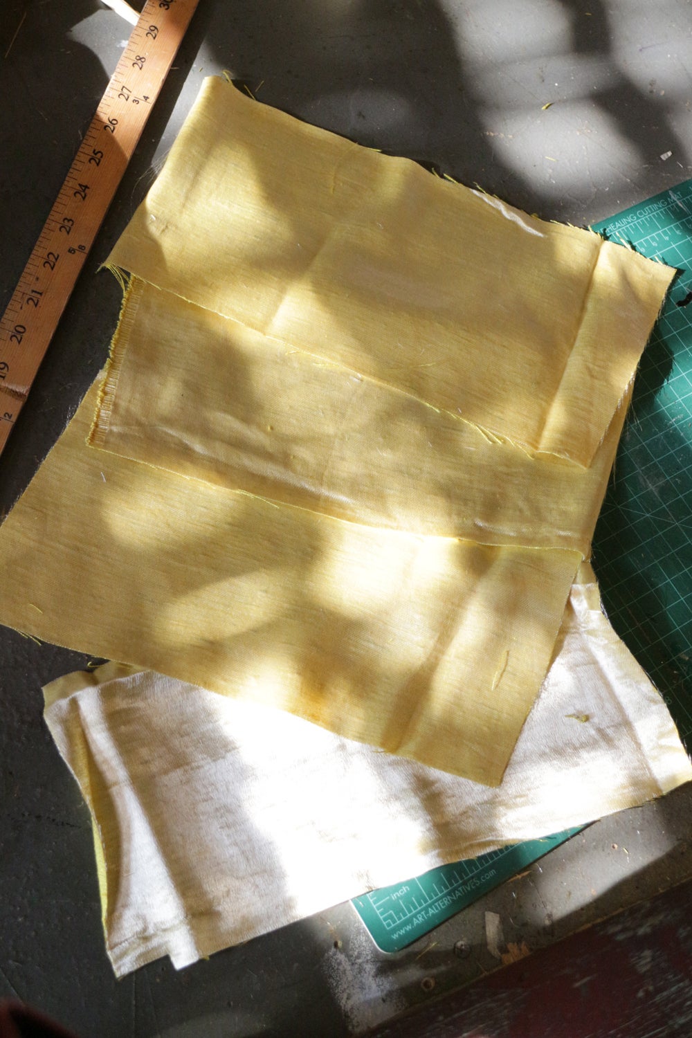

I found some really nice buttery yellow fabric, that was kind of a pain to sew, but It was too pretty and shiny to deny.
I cut 5 pieces of 7" x 12" fabric, and sewed them into 6"x11" rounds.

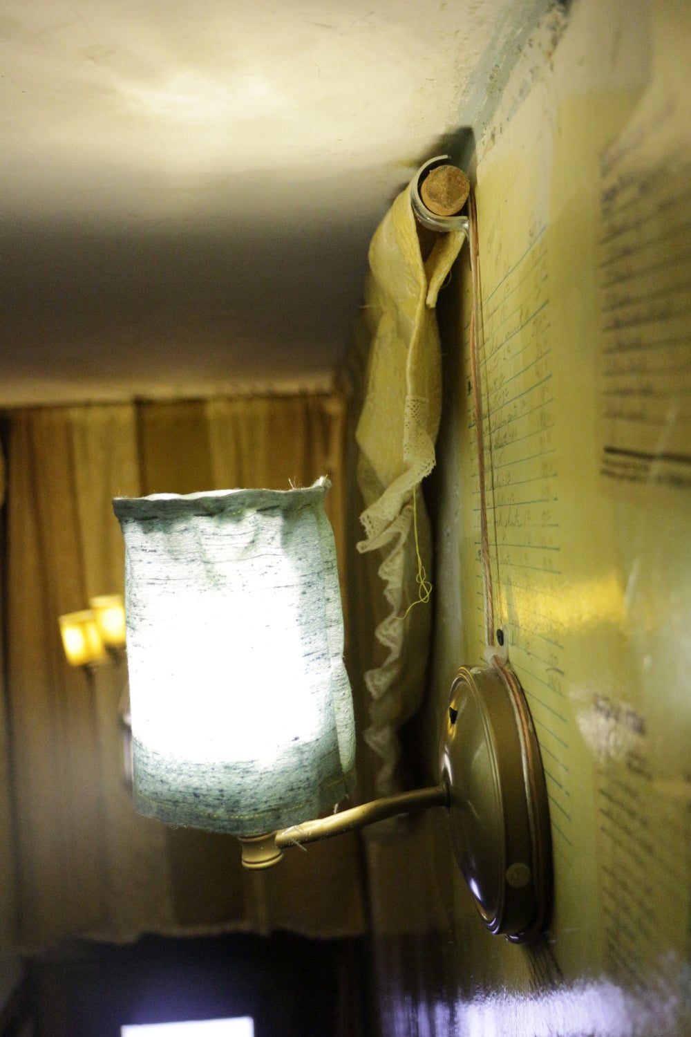

Step 33: The Sconces

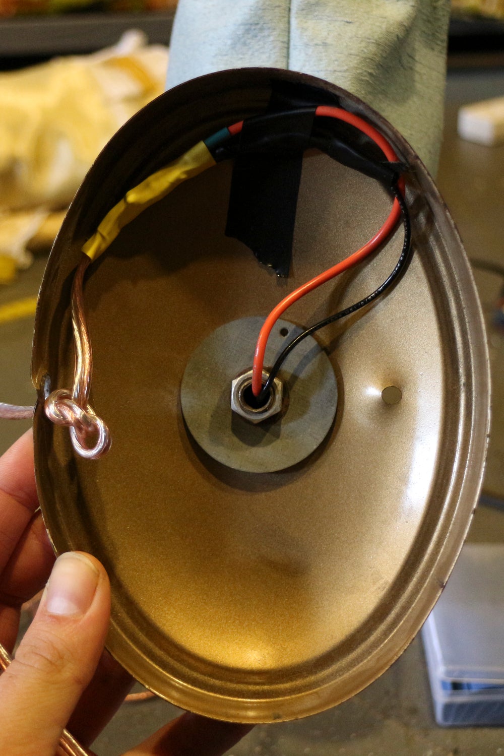

I cleaned these just like I had cleaned the other lighting fixtures, and then plumbed them with wires that would make sense for DC wiring.
Step 34: Sconces: Light Bulbs
Just like the other bulbs, I used a wooden dowel. To get the dowel rod to nest nicely within the opening for the light, I had to chisel out a small wire chase for the LED strip.
Step 35: Sconces: Shades
Using the same 'cup technique' I made shades for the sconces after the bulbs were in place.
Step 36: Sconces: Testing
Neat! It works!

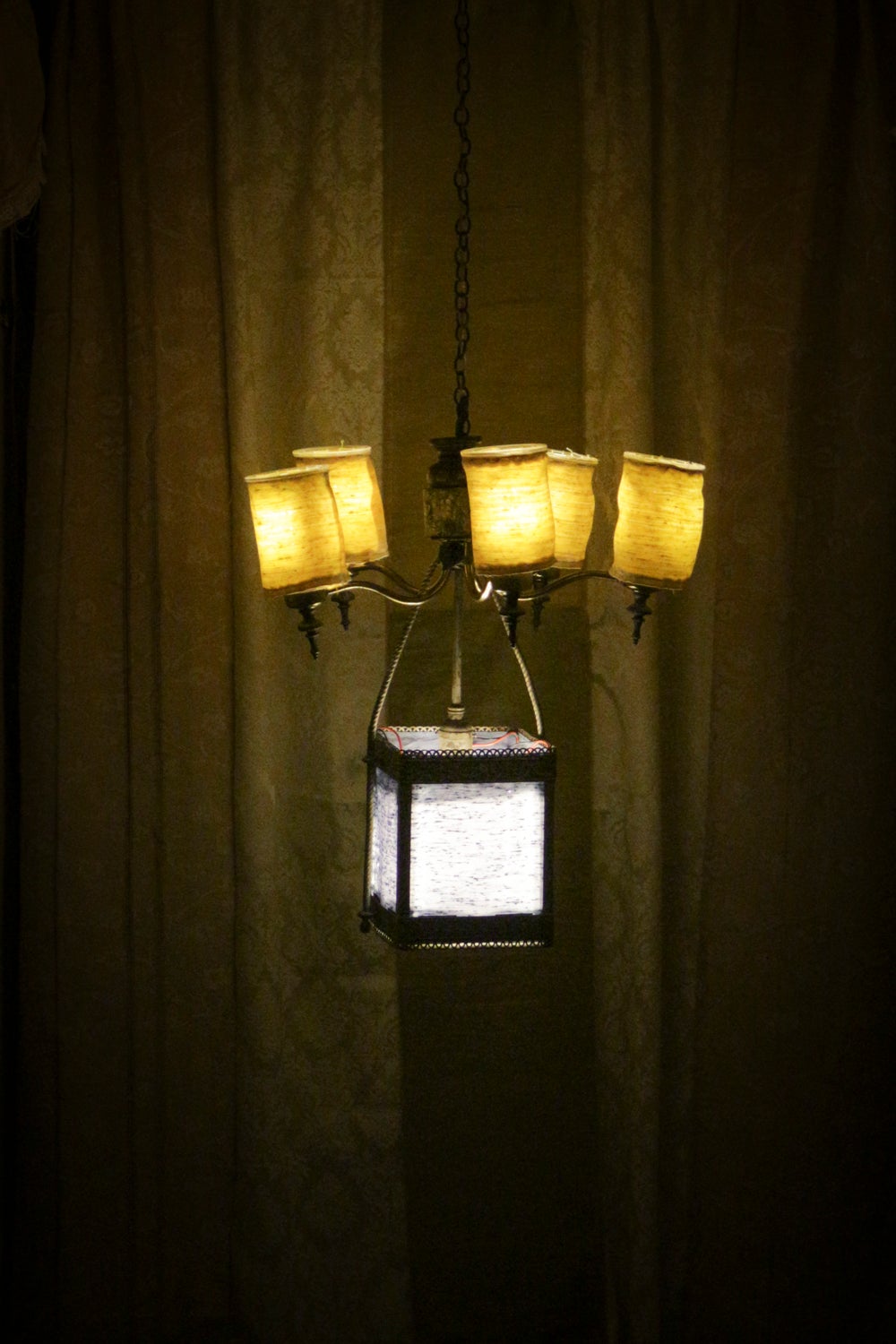

Step 37: Uniting the Fixture
I wanted to mush together the box lamp with the chandelier. I wired them to one common junction, and wove some collection thread in between the two, so there wouldn't be too much wire strain.
Step 38: More Testing.
Daaaang. That looks great. Let's hang that sucker.

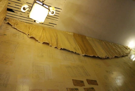

Step 39: Tapestries
I went through Elsewhere's amazing fabric library, and found some nice golden-ish yellow scraps to sew into tapestries. I wanted the tapestries to fill the void of the sculpture that was removed in the stairwell.
I had to cover a scallop shaped space that was 12x3 feet on each side, as well as a 4x6 space at the top of the stairwell.
Step 40: Tapestries Coming Together
I ended up sewing 3 different pieces - my choices for assembly were indicated by the fabrics I found. I tried to find pieces that would fill that space instead of trying to cut pieces down to size, I mushed old scraps together to make cohesive tapestries.
One ended up being quite heavy.

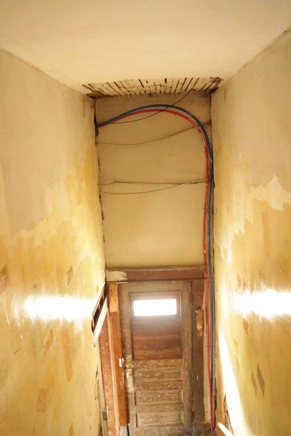

Step 42: Install!
This process took a while. I couldn't have been able to do it without the help of the Elsewhere Staff, particularly Cyrus Smith, Courtney McCracken, and Lyric Morris.
We had to plumb a new 120V line from a different part of the building to bring light to the stairwell. (TURN FUSES TO OFF POSITION BEFORE TAMPERING WITH AC CURRENT!)

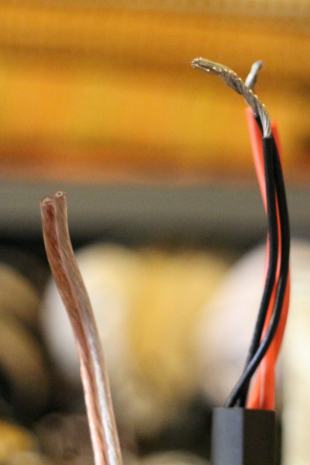

I used speaker wire to route DC current from the adapter to each light. Speaker wire looks great, and is clearly marked with positive and negative lines. It is also rated to handle more current than I would ever be pumping to this circuit (i.e. very safe choice)
Step 45: Wiring the Chandelier
I wove speaker wire through the chain of the light, and covered up the messy coupling bit with an old chair leg. It looked great.
