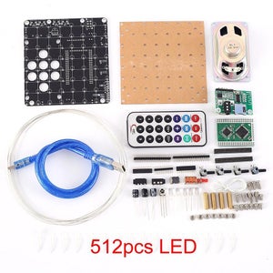

About the 8x8x8 LED Cube:
- This is a light cube DIY kit that you need to solder and assemble by yourself in much of patient. The bottom plate comprises a circuit board and component parts. The 512 LED lights make up a stereo space. A variety of cool model showing a three-dimensional effect.
Parameter:
- Work Voltage:DC 4.2V~5.5V
- Work Current:2000mA
- Power Type:MINI USB
- Work Module:Bluetooth/Remote Controller/Button
- Music Type:Bluetooth/U-disk/TF Card/Audio Input
- Work Temperature:-40℃~85℃
- Work Humidity:0%~95%RH
- Size(Installed):100*94*120mm(Different people installed, the height will be slightly different)

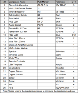

Step 1: Install 2pcs 20Pin*2 1.27mm Male Pin and 1pcs 10Pin 1.27mm Male Pin
Install 1.27mm Male Pin on Green Main IC Controller Module.
Please pay attention to the installation direction. Connect these 2 pads at the same time.

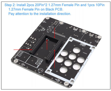

Step 2: Install 1.27mm Female Pin on Black PCB
Install 2pcs 20Pin*2 1.27mm Female Pin and 1pcs 10Pin 1.27mm Female Pin on Black PCB.

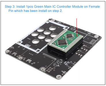

Step 3: Install 1pcs Green Main IC Controller Module
Install 1pcs Green Main IC Controller Module on Female Pin which has been install on step 2.

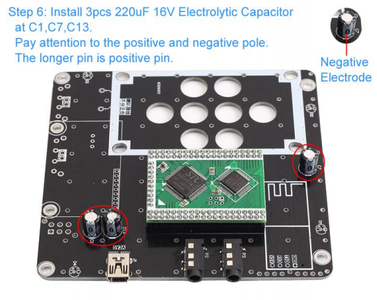

Step 6: Install 3pcs 220uF 16V Electrolytic Capacitor at C1,C7,C13
Install 3pcs 220uF 16V Electrolytic Capacitor at C1,C7,C13.
Please pay attention to the positive and negative pole.The longer pin is positive pin

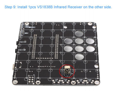

Step 9: Install 1pcs VS1838B Infrared Receiver
Install 1pcs VS1838B Infrared Receiver on the other side.

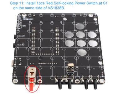

Step 11: Install 1pcs Red Self-locking Power Switch at S1 on the Same Side of VS1838B
Install 1pcs Red Self-locking Power Switch at S1 on the same side of VS1838B.

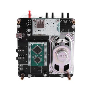

Step 12: Install 1pcs 3W 4ohm Speaker and Fixed
Install 1pcs 3W 4ohm speaker and fixed.
Note: The speaker does not distinguish between positive and negative.

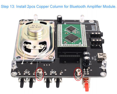

Step 13: Install 2pcs Copper Column for Bluetooth Amplifier Module
Install 2pcs Copper Column for Bluetooth Amplifier Module.
Step 14: Install 1pcs Bluetooth Amplifier Module and Fixed by Screw
Install 1pcs Bluetooth Amplifier Module and fixed by screw.

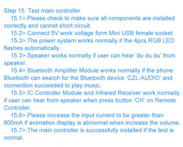

Step 15: Test Main Controller
- Please check to make sure all components are installed correctly and cannot short circuit.
- Connect 5V work voltage form Mini USB female socket.
- The power system works normally if the 4pcs RGB LED flashes automatically.
- Speaker works normally if user can hear ‘du du du’ from speaker.
- Bluetooth Amplifier Module works normally if the phone Bluetooth can search for the Bluetooth device ‘CZL-AUDIO’ and connection succeeded to play music.
- IC Controller Module and Infrared Receiver work normally if user can hear from speaker when press button ‘CH’ on Remote Controller.
- Please increase the input current to be greater than 800mA if animation display is abnormal when increase the volume.
- The main controller is successfully installed if the test is normal.

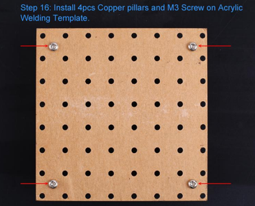

Step 16: Install 4pcs Copper Pillars and M3 Screw on Acrylic
Install 4pcs Copper pillars and M3 Screw on Acrylic Welding Template.

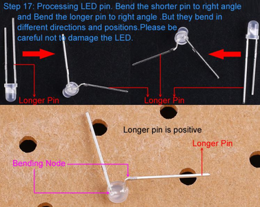

Step 17: Processing LED Pins
Processing LED pin. Bend the shorter pin to right angle and Bend the longer pin to right angle, but they bend in different directions and positions.
Note: Longer pin is positive.Please be careful not to damage the LED.

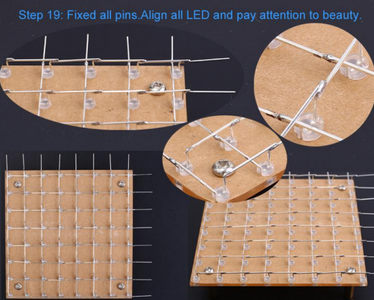

Step 19: Fixed All Pins
Fixed all pins. Please align all LED and pay attention to beauty.

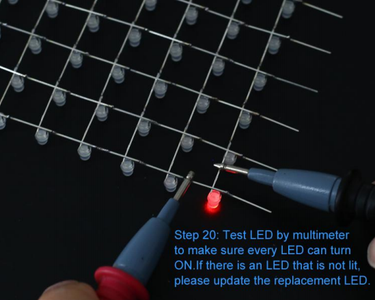

Step 20: Test LED by Multimeter
Test LED by multimeter to make sure every LED can turn ON.
If there is an LED that is not lit, please update the replacement LED.

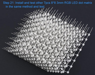

Step 21: Install and Test Other 7pcs 8*8 3mm LED Dot Matrix
Install and test other 7pcs 8*8 3mm RGB LED dot matrix in the same method and test.

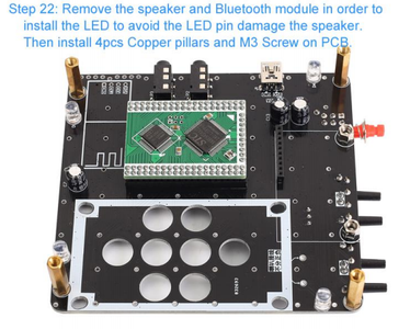

Step 22: Remove the Speaker and Bluetooth Module
Remove the speaker and Bluetooth module in order to install the LED to avoid the LED pin damage the speaker.
Then install 4pcs Copper pillars and M3 Screw on PCB.

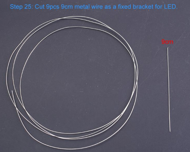

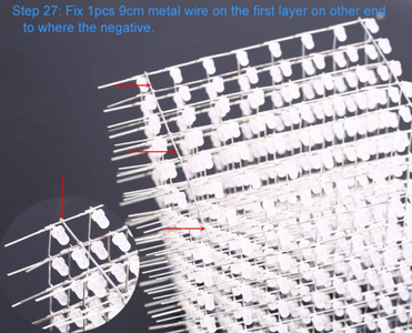

Step 25: Cut 9pcs 9cm Metal Wire
Cut 9pcs 9cm metal wire as a fixed bracket for LED.

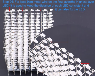

Step 26: Fix 1pcs 9cm Metal Wire on the First Layer
Fix 1pcs 9cm metal wire on the first layer (the Highest layer LED).
It is used to keep the distance of each LED consistent and it can also fix the LED.
Step 27: Fix 1pcs 9cm Metal Wire on the First Layer on Other End
Fix 1pcs 9cm metal wire on the first layer on other end to where the negative.

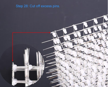

Step 28: Cut Off Excess Pins
Cut off excess pins.

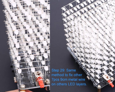

Step 29: Same Method to Fix Other 7pcs 9cm Metal Wire on Others LED Layers
Same method to fix other 7pcs 9cm metal wire on others LED layers.

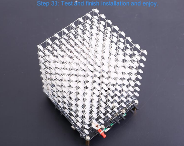

Step 33: Done
Test and finish.
