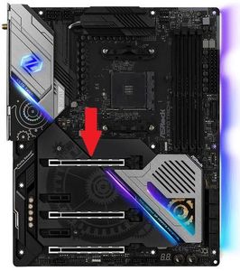

- How To Add GPU Onto Motherboard. The GPU is fairly easy to input. On the motherboard there are big line channels, that look similar to the RAM channels, but much larger and usually found under the CPU, and in the middle of the motherboard. Above is a photo showing an arrow pointing on where to input the GPU. The graphics card will be inserted similarly as the RAM stick. A click should be heard and it is securely inserted. Depending on your PCe the graphics card usually has a 12-16 pin slot. The same way you inputted the pins onto the back on the back of the power supply, you will put the pins again as well depending on the wire used you will align the PCe cord to the amount of pins needed. In the first video seen you can go to minute 17:40 and see how to insert the graphics card, and minute 19:10 shows how to plug in the PCe into the graphics card and power supply.
