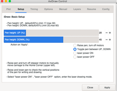

Step 14: Install the Software and Set Up the Default Parameter
Download the software here

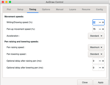

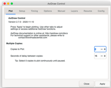

Find extension->Axidraw Control and set up the default parameter as images
Step 15: Test the Pen Holder by Click the Apply Button in Setup
You can test if the pen holder drive works well or not by click the APPLY button in setup as image. If it can move up and down, your machine is ready to draw now. About the pen height, you can leave around 5cm when it's up.
