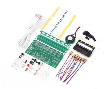

This Laser Harp kit is one of the best sellers among our diy kits categories.

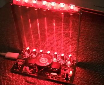

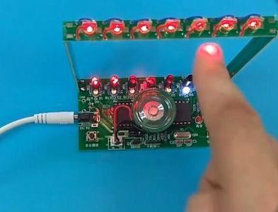

There are a total of 7 strings. When the string is cut, the buzzer sends out the corresponding sound level. When the string is cut, the LED of the string is lit up.
Laser harp’s strings is replaced by laser beam. You can play the laser beam as a string. Each beam has a different pitch. It's very interesting to assmbly and play it with kids at weekend

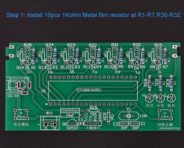

Step 1: Install 10pcs 1Kohm Metal Film Resistor

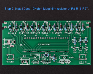

Step 2: Install 9pcs 10Kohm Metal Film Resistor

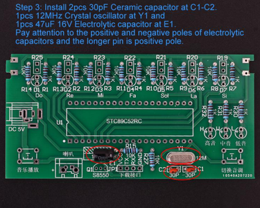

Step 3: Install Ceramic Capacitor, Crystal Oscillator, Electrolytic Capacitor
Install 2pcs 30pF Ceramic capacitor at C1-C2.
1pcs 12MHz Crystal oscillator at Y1.
1pcs 47uF 16V Electrolytic capacitor at E1.
Please ay attention to the positive and negative poles of electrolytic capacitors and the longer pin is positive pole.

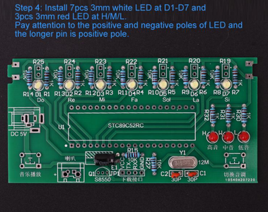

Step 4: Install 7pcs 3mm White LED and 3pcs 3mm Red LED
Please pay attention to the positive and negative poles of LED and the longer pin is positive pole.

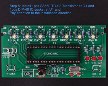

Step 5: Install 1pcs S8550 TO-92 Transistor and 1pcs DIP-40 IC Socket

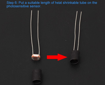

Step 6: Put a Suitable Length of Heat Shrinkable Tube on the Photosensitive Sensor

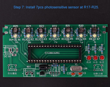

Step 7: Install 7pcs Photosensitive Sensor at R17-R25

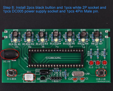

Step 8: Install Button, Socket and 4Pin Male Pin
Install 2pcs black button and 1pcs white 2P socket.
Install 1pcs DC005 power supply socket and 1pcs 4Pin Male pin.

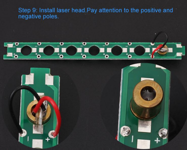

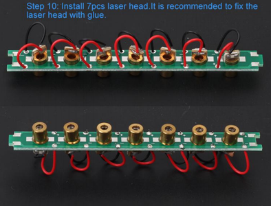

Step 9: Install 7pcs Laser Head

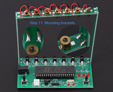

Step 10: Mounting Brackets

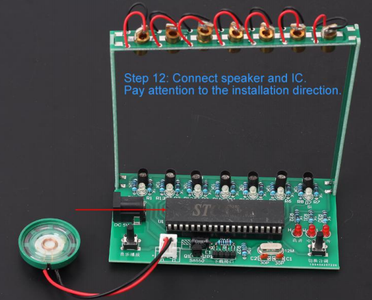

Step 11: Connect Speaker and IC

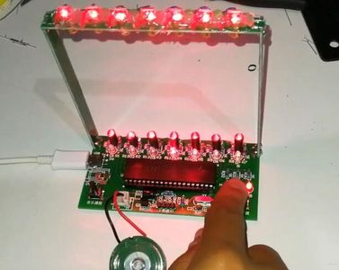

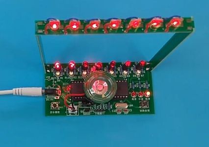

Step 12: Done! Enjoy the Time to Play Laser Harp
