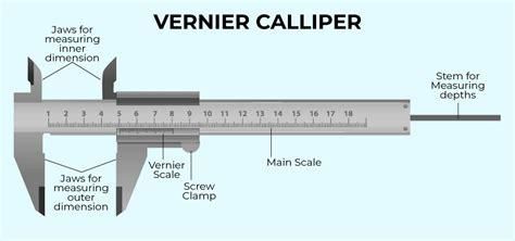

Step 2: Take Measurements
Use a device that can measure distance to figure out the dimensions of the parts.
I highly recommend a pair of calipers.
You could also add the dimensions to the sketch you made.

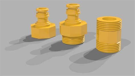

Step 3: Start Modeling!
If you want, you could model the two objects that you are connecting in the CAD software, but it isn't required.
  1. You can use the reference models to make sure that the design that you have envisioned has the correct measurements
measure the dimensions that your part will attach to with a pair of calipers or a ruler.
Then model the part that you want, making sure that the dimensions are correct.
When modeling, remember, printers are not perfectly precise and if the tolerances are too tight, your print will be too small to connect to your part.
  1. To avoid this, the rule of thumb is to allow an additional 0.4 millimeters of empty space, however the exact amount you will need to add will vary on the printer and how it is configured.
